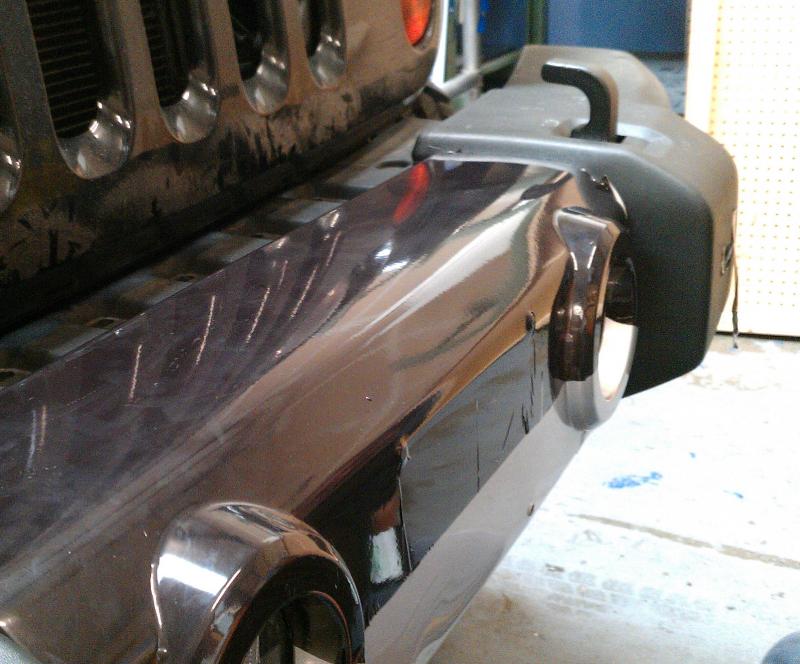

Not one cut, no primer, No stretching marks, No tears. We wrapped couple of jeep wrangler bumpers from silver to gloss black.
Ironically working on this TODAY.
in 2 pieces for the front, and 1 in the back.
I'm your hero!!!!!!!!!

Are the silver and black separate or one piece of vinyl laid in? If one piece, you used no heat and no primer? Please tell me yes (don't lie) I would like to think that the vinyl would conform (and stay) like that without heat and primer.
Smacka
Opps, you did say it was separate. I can see the edge and what looks like fingers in your black and your silver looks crooked going into the light. Not ready to worship quite yet.:banghead:
HulkSmash
Do you read? It's a full BLACK wrap bumper. It's in 2 Pieces. The silver part is still the bumper. NO PRIMER, NO RELIEF CUTS.
Again the Silver is the bumper that hasn't been warped yet.
Again. NO primer. Yes, obviously we used heat. No Relief Cuts..
The black part isn't even pressed down in the middle, it's drapped, But yes we wrapped the fog lights.
