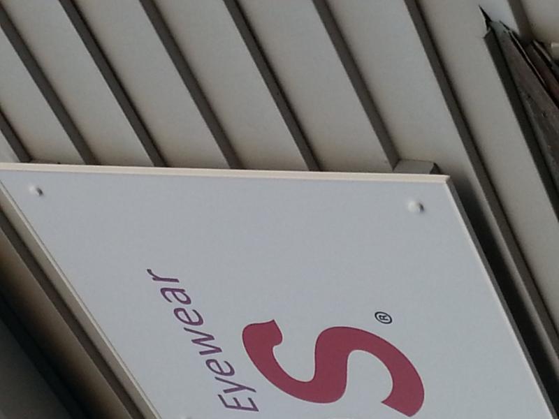

Here is a pic of a sign that is currently on the building.
I want to make mine similar.

My initial idea was just getting an 040 or 060 aluminum but whatever is up there now is around .25".
They used a 2 pieces of wood that run the whole way under the sign, I am not sure if I want to do it that way, any recommendations both on what way to hang and what material I should use?
It is 2' x 9' outside.

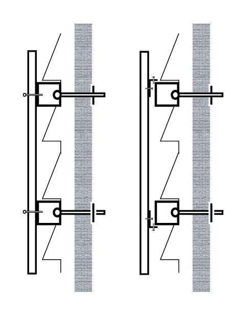

- mount extruded aluminum tube to building. full lengths or just a few pieces for corners/center, toggle-anchor'd.
- sign is then either screwed directly to aluminum tube or fasten angles to the backside of the sign to "cap" the aluminum tubing you've mounted and zip-screw in place from top/bottom.
or, i guess, you could just simply use angles for it all. I just happen to have a LOT of aluminum tube around the shop, so it is easy to use scrap cutoffs for mounting blocks.

I was thinking of attaching the 1.5 x 1.5 mounting wood pieces running horizontally (like the picture) and I like the "L" brackets on the back so I do not have to drill into the front.
So would the way to do this be going and attaching the wood mounting pieces and then just measuring the gap and then using that measurement to know where to attach the L brackets on the back of the sign and than (hope) it all matches up and screw them in?

i'd mount the brackets on the siding first, since you're bound by where the best "flat spots" are between the seams of the siding. measure the gap and then fasten angles to the back of the sign to match.
noted: you'll end up crushing the siding when you torque your brackets/toggles down, but you gotta do it to make sure the sign don't go anywhere. so moving the building-mounted brackets inward would be ideal to hide the damage better.
any penetrations through the siding should also be addressed. silicone caulk or a gasket, maybe? water will find its way into the penetrations if left unsealed, and the siding is there in the first place to protect what's underneath from the elements.
