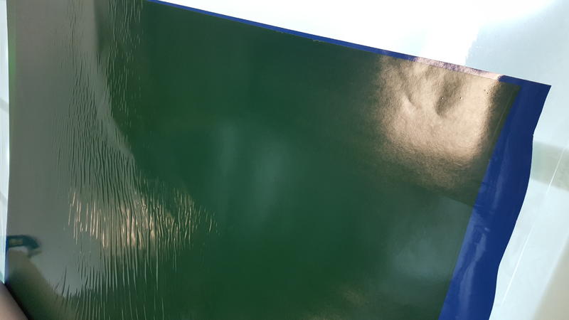

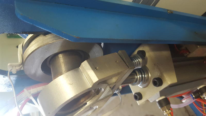

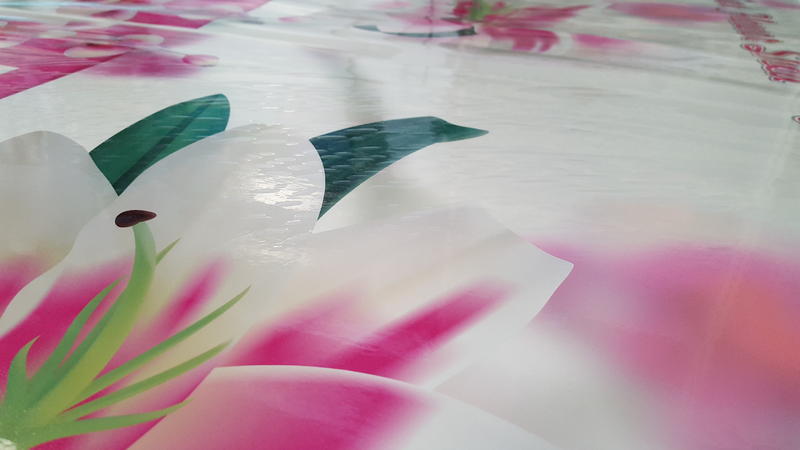

My Fayon Laminator just turned up 3 weeks ago, I could write an entire essay on the disappointment with my flatbed Laminator.
The table frame is uneven, when the roller runs over it creases the vinyl and creates bubbles throughout the whole length of the laminator. The steel is rusty when the paint has been scratched. Looks like the frame has been left in the weather for long time.
The roller has already fallen off the machine and broken the heater core (Second Day), Cables too short and jammed between the steel casing and LED’s flicker randomly
I was told they have seen the manufacturing issue before and their only recommendation is pack steel between the supports to support the glass ;\ to level it,
With the glass weighing 300kg so not looking forward to lifting up and down without breaking it. With 13 supports have gaps ranging from 1 to 4mm so its going to be a roulette game to find which one needs supporting and which ones doesnt.
I offered to pay for one of their experienced engineers with the correct tools to fly over but they advise they are too busy to fix the issue and won’t provide any assistance or compensation.
I would highly recommend to stay away from this machine and pay for a named brand who supports there products locally or spend the time building your own.
Also it only sits at 80cm high so very painful working height unless your 5ft tall
I would highly recommend to stay away from this table (I can’t even call it a laminator), what a waste of $10,000k.
After doing some further research i found 3 people who bought these locally and they also similar manufacturing issues

How many adjustable legs does it have? You could use a laser level to try to get it level.
Can you modify the legs to be longer to raise it up to a more comfortable height?
Geoff897
It has 6 legs, They have the casters and then a single 12mm thick screw peg type foot where you can screw/raise it maybe maybe 50mm at most.
1m is comfortable table height so needs to be almost 200mm higher, With the weight and size of the standard legs i would not trust the 12mm screw bolt raising it 200mm. Table weight is about 800kg glass is about 300kg
I have used the laser level to level the table so that is not it, Its the supports holding the glass that are uneven, When the roller goes over the glass its dips a different amount over each of the 13 supports creating the bubbles. Each of the 13 supports needs a different thickness to support the glass with just the weight of the roller running across it. The dips are also not the whole width of the table so some will need supports ie. 3mm 800mm long some 2mm 300mm long across the 13 supports
