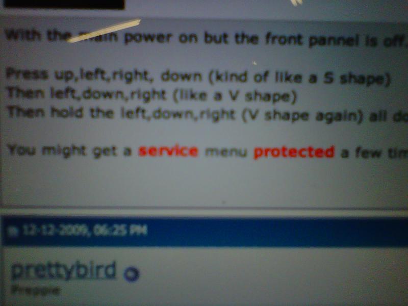

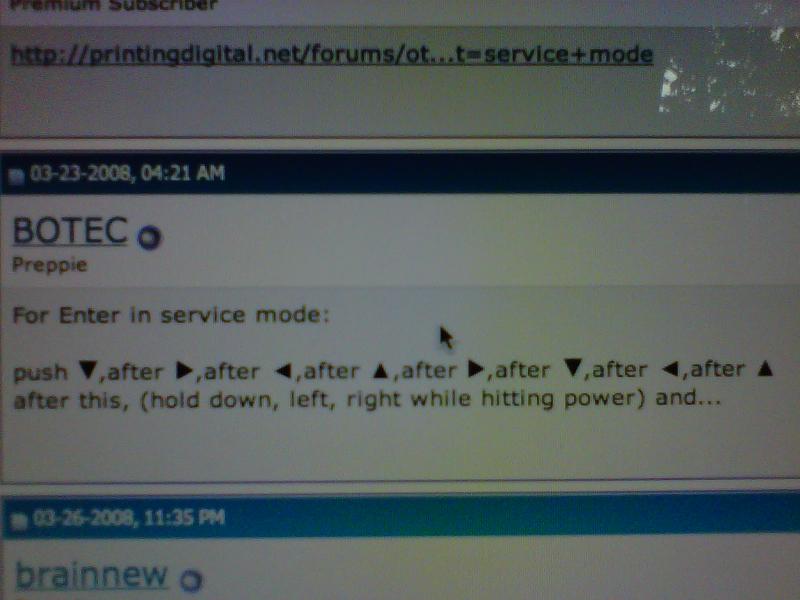

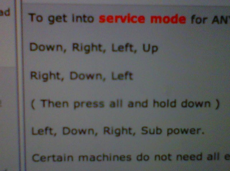

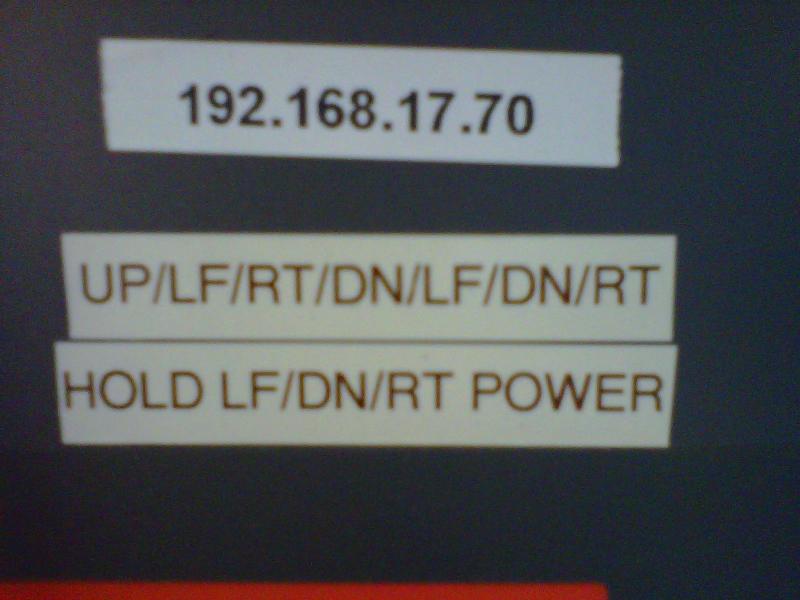

Here are 4 service code options attached for you. I keep these on my phone. Some of them are pics taken directly from the forums here. Some codes I notice will not work the first time but the second or third try they get past the service protected option.
I have went through the exact same thing with Roland dealers as well.... to be honest I have had the same problem with Mutoh and Mimaki is even worse FROM MY personal experience...this may vary from individual, region and dealer.
Its nice how you can drop a coin on these and the salesman don't stop calling you...but trying to get you back up and running is like pulling teeth....and forget trying to get a tech out next day.
Its time for you to get a nice set of magnetic tip screw drivers and make sure the power is completely disconnected when replacing parts.
Keep ink away from the electrical ribbons and connections points on the print heads.
Hope this answers your inquiry.
Good Luck.

Tim
Service Mode
Try Down, Right, Left, Up, Right, Down, Left...
Then Left, Down, Right and power on all at the same time. This is what worked my sp-300v.
best of luck!
