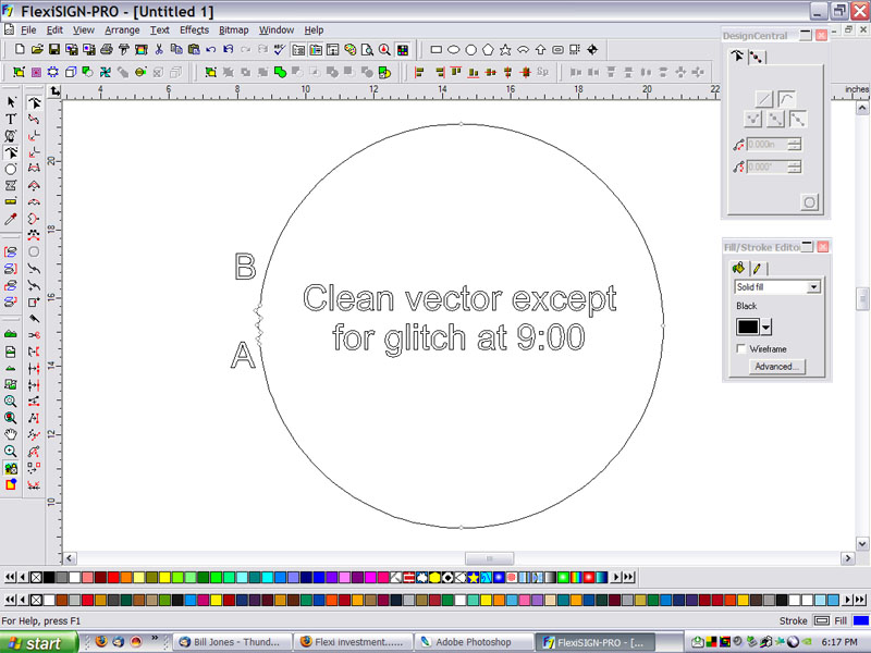

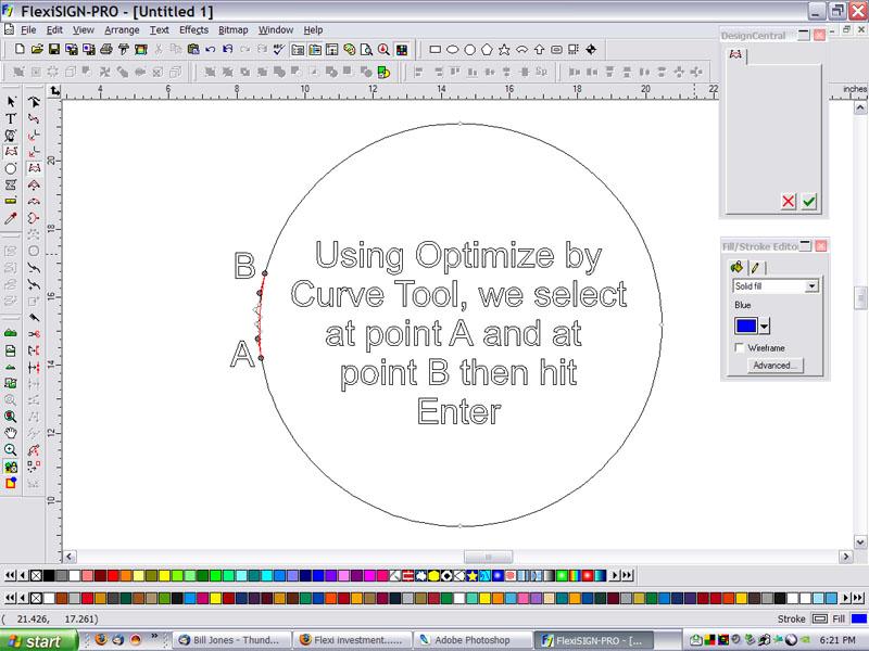

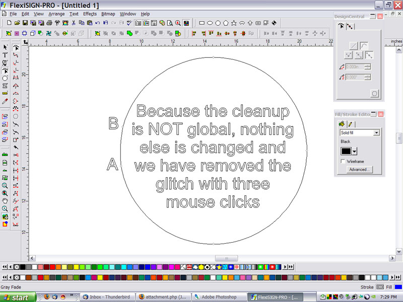

To fully explain would require a couple of dozen posts. Let me attempt to summarize my opinions:
Global approaches to vectorizing and subsequent path cleanup are generally inferior to either hand tracing or manual cleanup of autotraced vectors. The trick, therefore, is to provide efficient ways to inject myself as an artist and a technician into either of the preferred manual processes.
In the attachments below, I have created a 7 point glitch on a circle. My objective is to eliminate the glitch cleanly and accurately without changing anything with the balance of the vector. To do this I would first duplicate the vector and make it a guide to make sure I stay true to the original unless I feel artistically that something different should be the case.
Now let's count the steps to correct the glitch in Flexi.
1. Select the Optimize by Curve tool.
2. Click the path at Point A to set the start of where I will be optimizing.
3. Click the path at Point B to set the end of where I will be optimizing.
4. Inspect the proposed change that the tool will perform and, if okay, click the check mark on Design Central to execute the command. Basically the Point A and B selections are setting new points on the adjoining segments that pickup the angle and length required to retain the existing paths and to remove all nodes inbetween the points.
I'm done. Last time I looked in Corel or Illustrator I would have to:
1. Select the Node Edit or Direct Select tool.
2. Marquee select the nodes I want to delete.
3. Delete the selected nodes.
4. Adjust the control arm on remaining bottom node.
5. Adjust the control arm on remaining top node.
6. Hope I got it right and didn't change anything on any adjoining path segments.
Multiply this by dozens or even hundreds of similar edits and a significant difference emerges in both time and accuracy.
