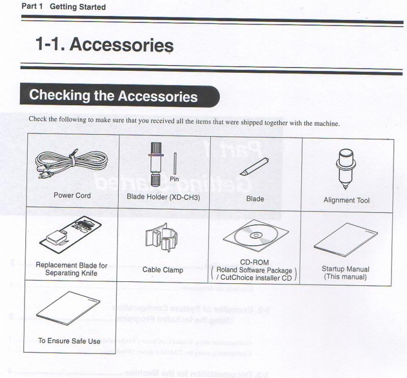

any roland ive ever owned......IVE NEVER RUN IT OVER 100..........on the down force!!!!!
for regular vinyl!!!!!! YOU DONY HAVE A PEN FOR THE PLOTTER??? i thought you just bought it????? IT COMES WITH ONE IN THE BOX!!!!!!
Actually it doesn't. We didn't get one when we purchased ours new 3 years ago. I also just checked the Roland website. Here is the list of included items:
AC adapter, power cord, blade, blade holder, separating knife, roller base, tweezers, test-use material, application tape, USB cable, CD-ROM, user’s manual
And Roland doesn't even list a pen (or pen holder) as an accessory for the GX24.
You've been a valuable resource on Roland plotters in the past but in this case you are just plain wrong.:Oops:
OldPaint

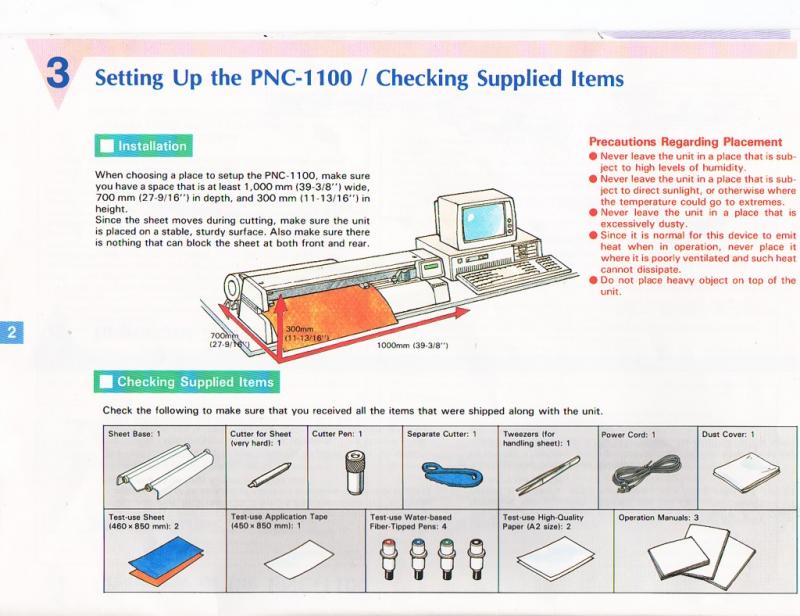

well i got a manual from a PNC-1000, PNC-1100, and ONE FOR A CX-300.......and all of em, show a PEN.............in the "in the box" list!!!!! for the cx-300 it is named ALIGNMENT TOOL!! i guess when you buy the cheaper one it might not come with a pen.

pens for a roland..............can be bought at any of the vinyl /plotter/printer supply places.
JAST ASK FOR EM!!!!!

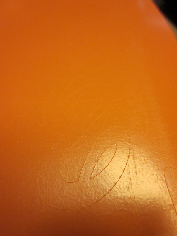

yours looks way worse than what mine does
I added an example of my dotted lines.

That's siser ps heat transfer material for textile prints. Does the same with other vinyls but as these are mat it shows better on picture.
I too have to put around120- 160 g of pressure to cut trough most calendered vinyls
