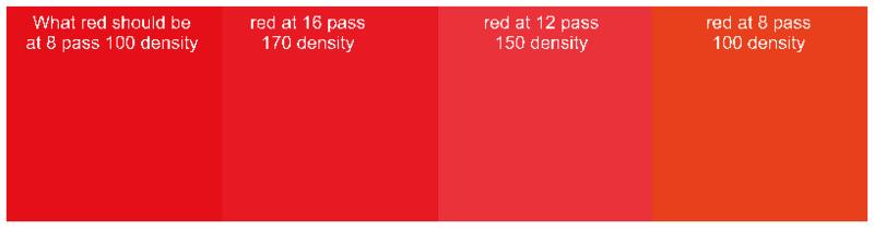

This illustration best describes what we're experiencing with the HP360

dypinc
At 8 pass what is your optimizer set to?
At 8 pass are you using CMYK only and not CMYKcm?
Lowest optimizer setting you can get away with and CMYK only, plus making your own linearization and profile will get you much closer to the red you want. Also consider 10 pass because you can use 120% ink density.

Always CMYKcm on all. Not sure of the optimizer setting. I'm not the print tech. I'll have to ask about that. We've cloned many of the profiles and tweaked the clones here and there but still have not seen acceptable color outputs at anything other than 16 pass. Especially if we're trying to color match previous Mimaki vehicle wrap prints.
To see any real advantage to the HP hype is to print at 8 pass and achieve acceptable colors.
I agree. I still don't see why HP limited these printer like they did. We need to be able to set higher ink densities at 10 pass and lower, and configuring it as a contone device only is very limiting. No chance of controlling light ink curves or maximizing ink limits per substrate.
Unfortunately it is what it is and you just have do what you have to do to get best output.
Having the L360 why are you cloning profiles? Creating new media (NOT CLONING) setups and a new calibration and profile will get you the best chance of achieving the color you want. When using 8 pass or lower using CMYK only if you can and limiting the optimizer as much as you can will get you the maximum gamut possible with these printers.
