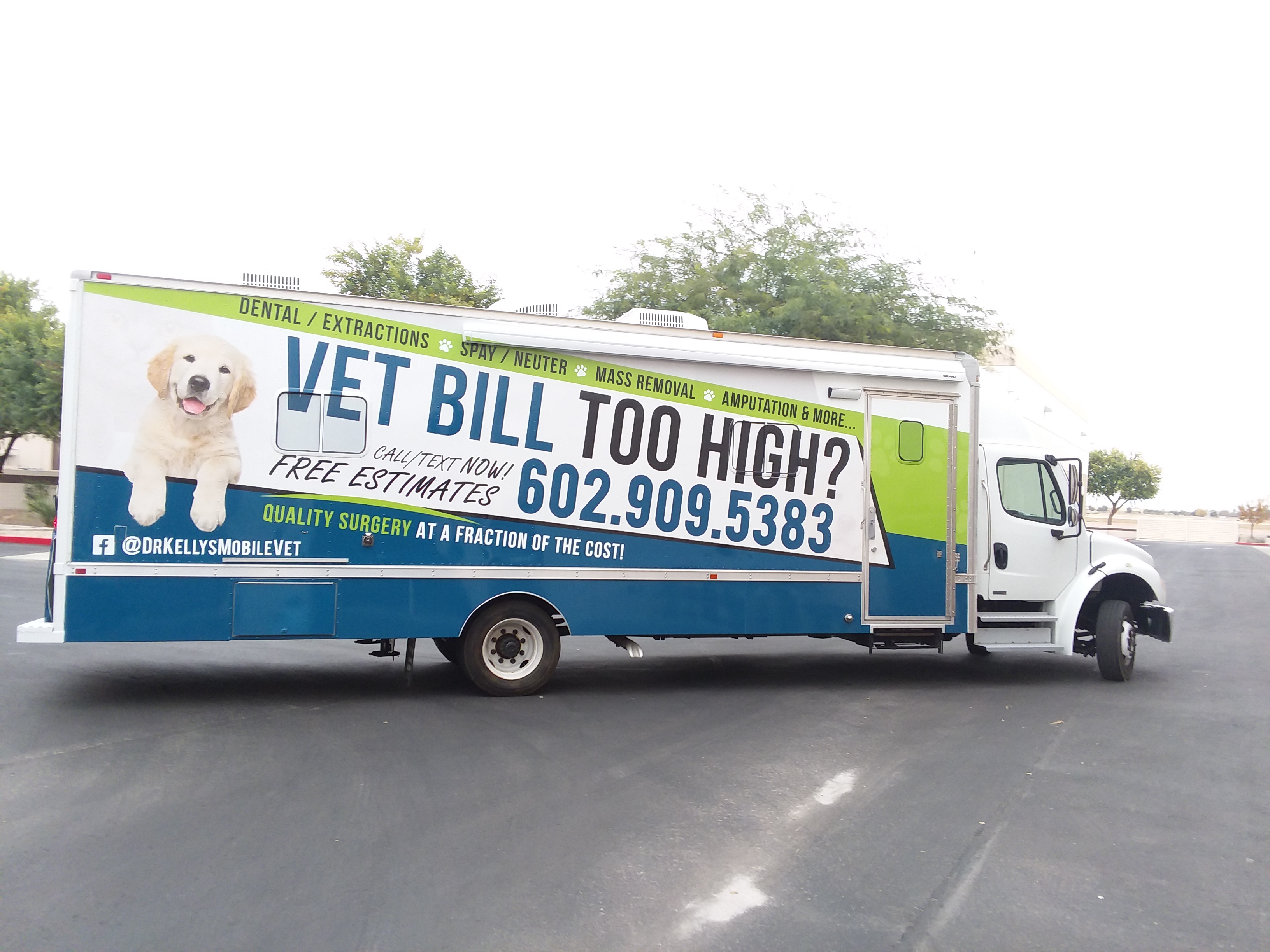

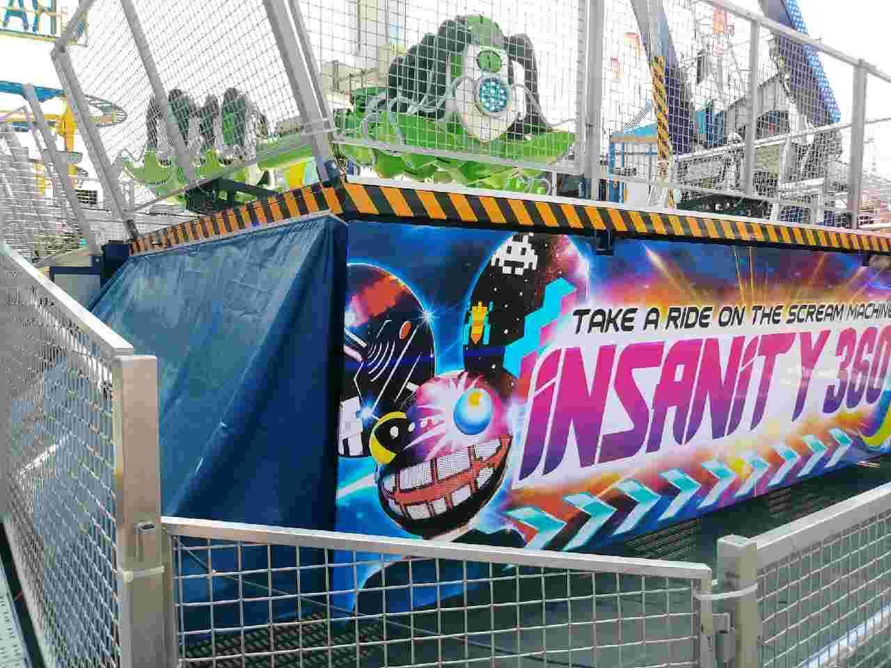

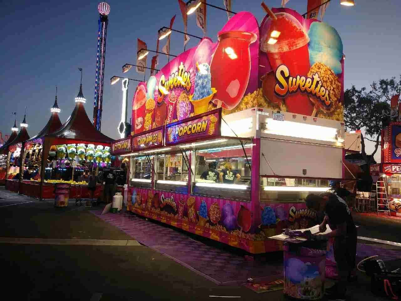

Yes, these are all 6 pass, all Avery 1105 + 1060Z
On the Yellow Trailer we only did the upper marquee and the lower banners but not the lower painted body in that image.
