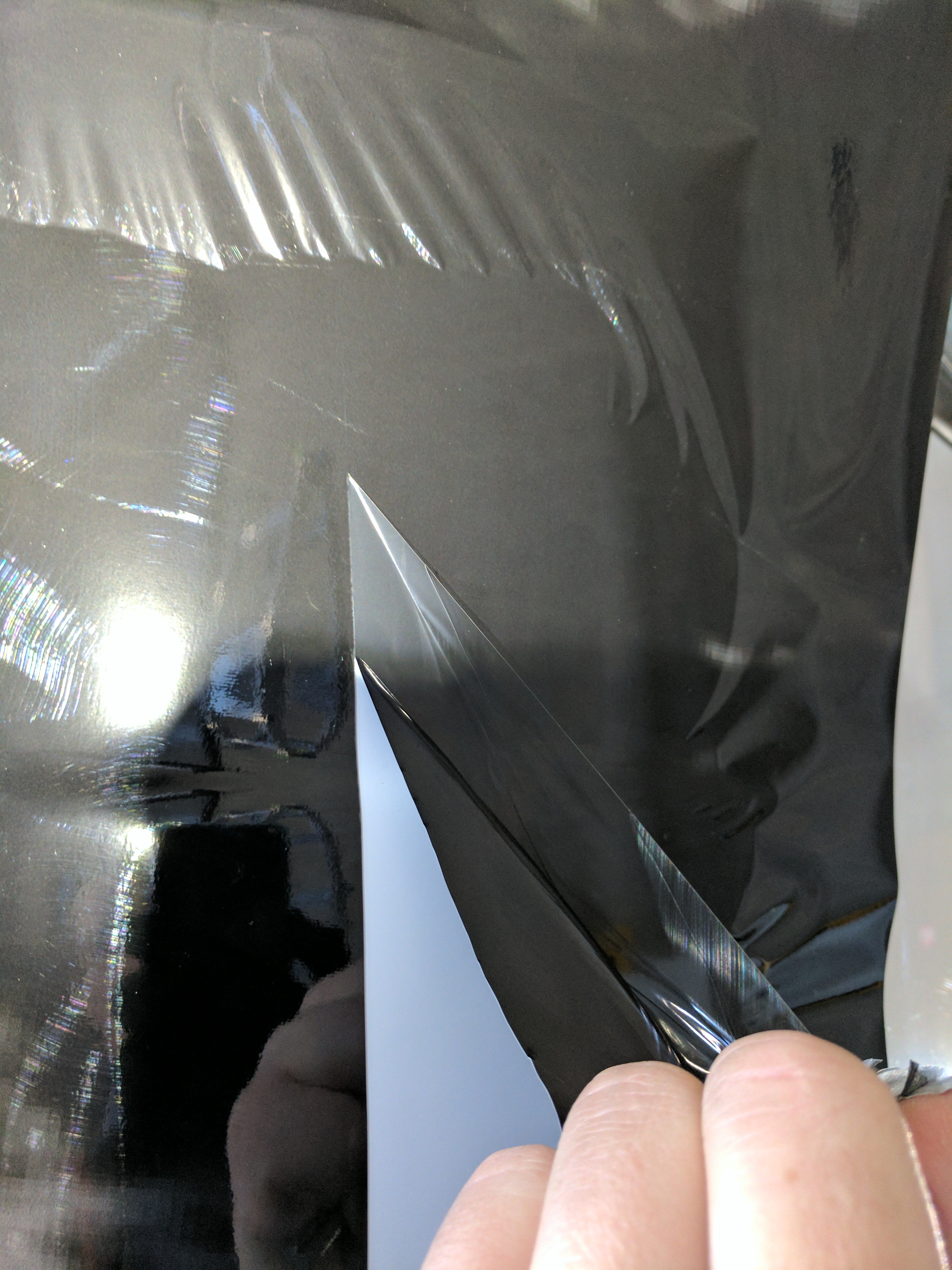

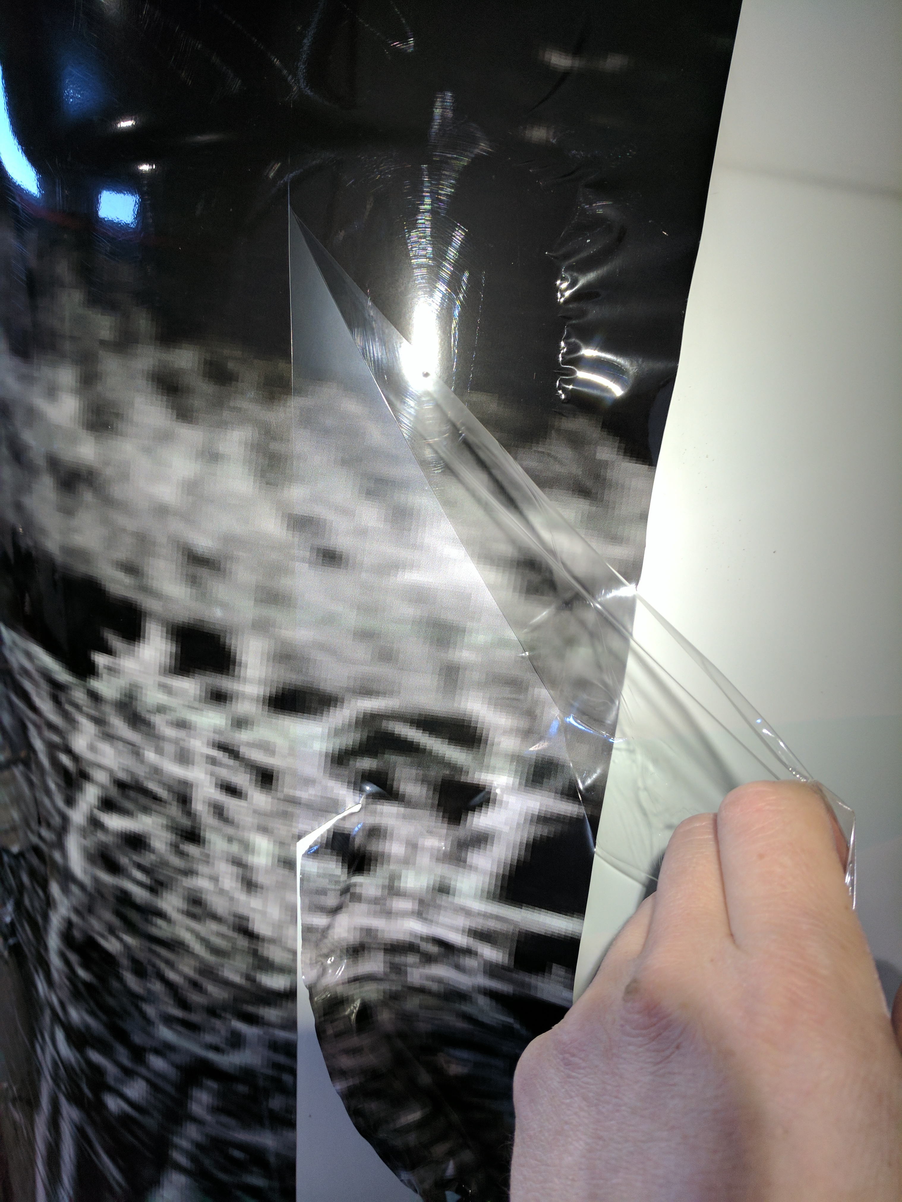

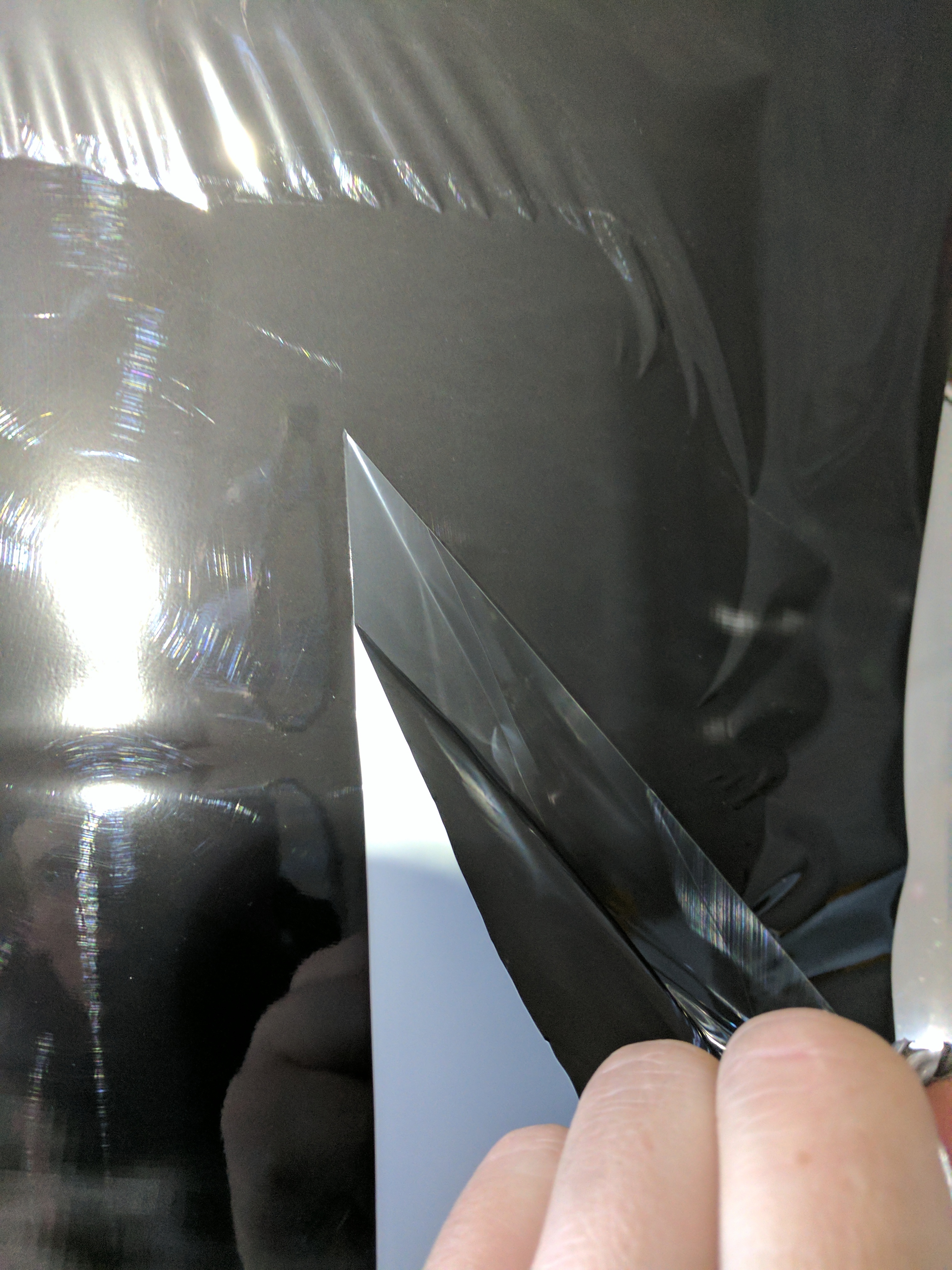

We've definitely had this issue with our 360. Have to be very careful when wrapping near a section already completed (side print of vehicle overlapping the hood or bumper then trimming and removing). Pulls away especially easily when pulling up trimmed section that's already tacked down like in the attached images.
I email our regional Avery rep and he asked for details that he could forward to their "quality team" (media/lam, print profile, rip, etc.). That was May of 2017 and I haven't heard anything since.
P.S. Don't judge me by the pixelation on this job, customer insisted on using his image on their 34' RV..
Holy crap! That almost looks like you'd be able to reuse the vinyl after you peeled the print off!
Slightly judging............ but not really. We all run into customers like this. Sometimes it is what it is.
lol, I hear ya. It looked just fine when you stood back far enough to see the entire image (15-20 ft), but up close....oof.
Pretty much, yeah. Didn't stretch in the least, just peeled away...
