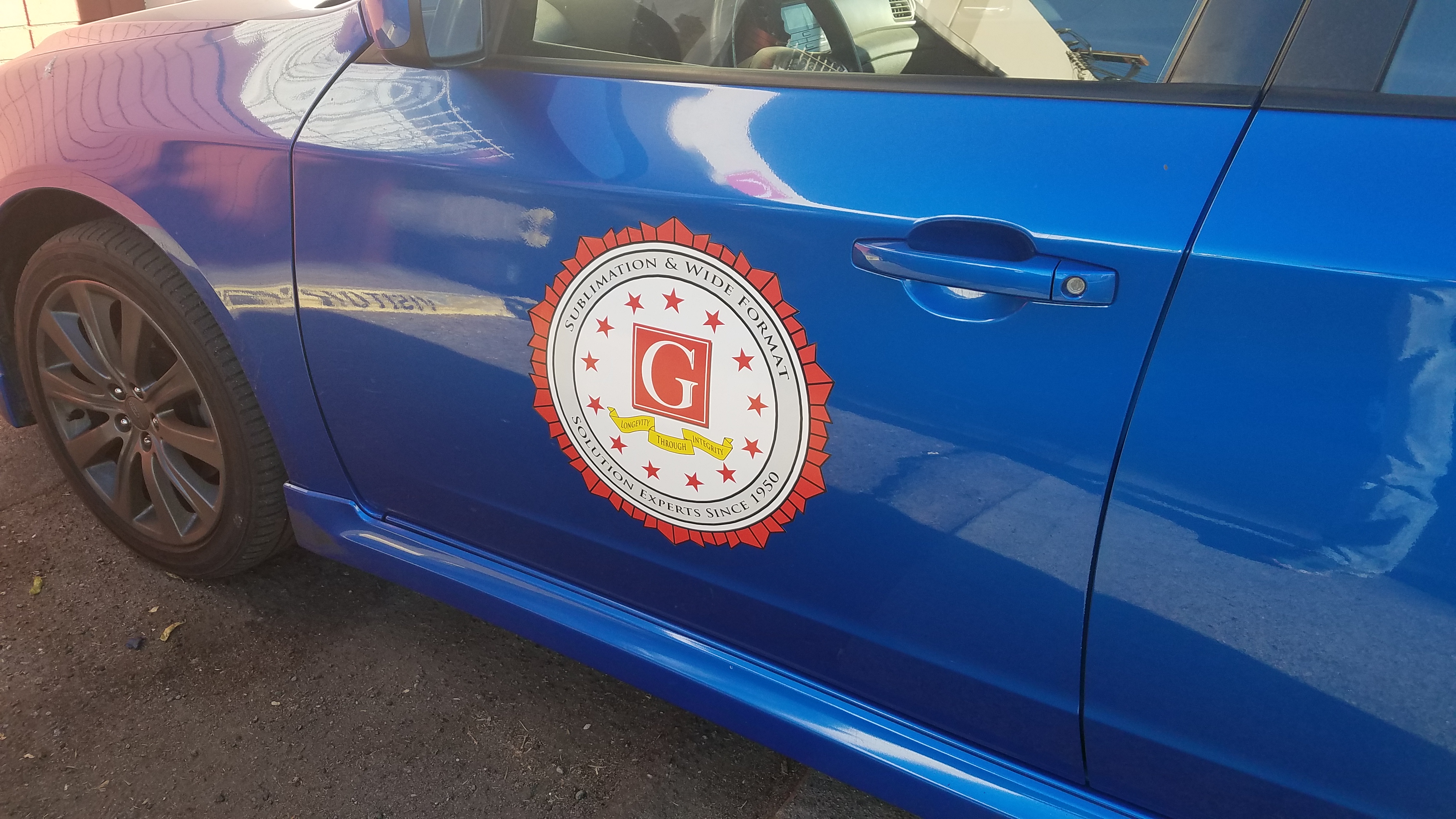

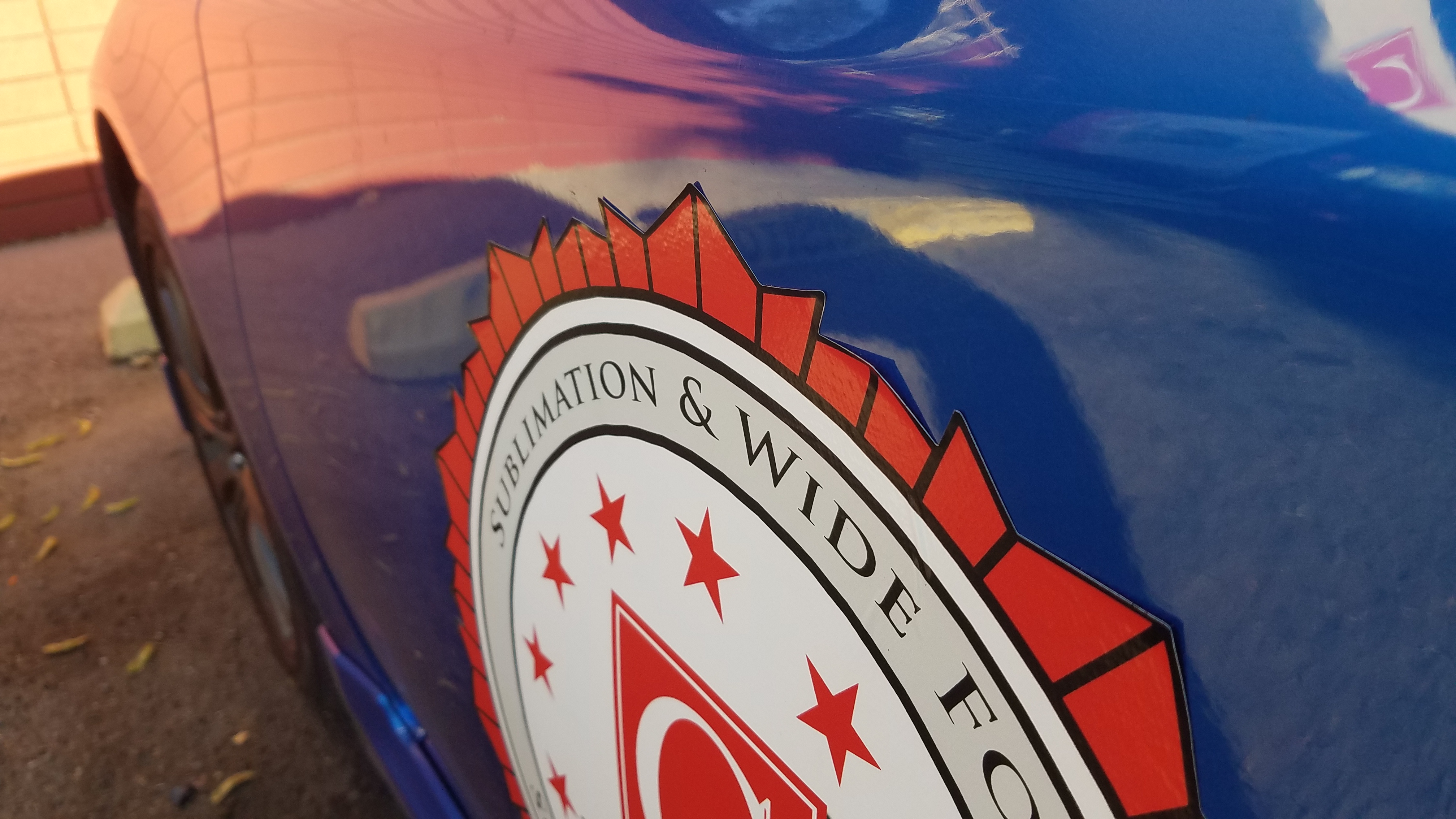

Does the outside temp matter? Can it be applied (and stay on) if it is in the 30s outside and the truck doors are cold?
I would say (living in Southern California where it can be a tad difficult to test in extreme weather) that it might be a little tougher to install in sub-freezing temperatures. That being said, it should hold up very well in those temps (once it's on) and at the end of the day it's designed, at least as vehicles are concerned, as a temporary graphic (under 1 month).
Indoors, it'll stay much, much longer. Depending on the surface you're good for at least a year, most likely much more.
It's been pretty chilly here in LA (mid 30's in the mornings) and the edges are JUUUUUUSST starting to lift a tiny bit, and we're now going on day 18 on my car, for what it's worth! (And, it's been incredibly dusty and smokey and nasty for many of those days.) Also, keep in mind that I used a very edgy (pun??!!??....) graphic to really get a good test. If it's rounder or square it'll hold better.
-jordan
SkyHighJK
Today is Day 19 and the iDot still looks great, IMO. Between the dust/smoke in the air, going 85 on the freeway, temps into the 30's at night (forming a nice dew layer on occasion) and daytime temps up to the mid-80's (which means the car door itself, in the afternoon sun, must get pretty darn hot) I'd say it's pretty impressive that the only corner-lifting is right at the top where my greasy fingers kept messing with the material to make that first video!
Full video coming later today (or, maybe, next week. I dunno, still feels like the Holidays, ya know?)
Have a great New Year everyone!
-Jordan
