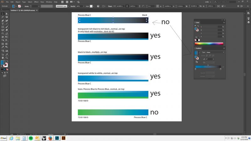

You would be surprised of the layer effects and styles you can do with Illustrator. If you give it a shot I would warn you of a few things.
Avoid pantone to pantone gradients...they will neutralize in the middle. Pick most critical spot color (which you can adjust in the rip) and a process color cmyk (no control at the rip)
The best way we have found to pull this off is the topmost object is, for instance, a gradient. Process Blue C 100% opaque to Process Blue C 0% opaque.
Make a copy of you object...send to back...place gradient object over it. You're basically making the gradient work with 2 objects. (see attached image)
Another thing to avoid is using blending modes other than multiply and normal...I've had objects with "overlay" blend mode not render in the rip...stick with multiply and normal...screen may work, testing required. :)
People shy away from building these effects in Illy because of what I've shown in my screen capture, the problem with Photoshop only is no control to correct at rip. The way I've shown, albeit more work up front, gives you the ability to correct a build on the fly, at the rip. (Simply find your named color in Onyx and adjust it) This way only the "critical" spot color will shift for you...not everything else! It's beautiful!

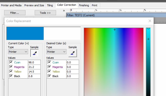

I found the color replacement area in job editor but it allows you to use an eye dropper to select color to choose but it only allows you to enter cmyk only.
Check your Spot color and see if that is a CMYK value as well, because I think that eye dropper value is the output value to the printer. That is the way it works in Colorgate. Once you know the CMYK output value for the spot color then you can change the incorrect color to that value as well.

I need to input a spot color not a cmyk color.. It allows me to select any color but it shows only a cmyk value even if it is the vector color.

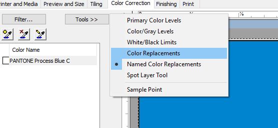

The only way i can actually select a spot color is if the file has it inbedded like a illustrator file.
Image attached. The other option is color replacement but it only allows me to input cmyk.
So i do not see a way to select a color and change it to a spot color so it prints like AI does.

You need to think of those CMYK value as a output color not an input color. That spot color your wanting ends up being a CMYK output color because that is how the printer is addresses. Because of the way your two color are read/input they output different The Spot Color Library tells what CMYK values based on your color management setting are to be sent to the printer. The CMYK input from raster gets told how to output based on your CMYK input profile covert by your CM to output CMYK values to your printer. Since the Vector Spot and the Raster do not have the same input values the output values will be different. The trick is and what the Color Replacement function should be is so that you can make those two different input colors the same output value that gets sent to your printer. There are also other uses for Color Replacement beside making your two colors print the same.
Your Vector Spot should show the CMYK value that is sent to the printer. If Onyx does not do that then that is a serious flaw, because in your situation you would have no way to know how to make those two colors match on the printer.
Do a test because those Color Replacement values should be the CMYK values that are sent to the printer. In the test you can try this. Make a CMYK input file with just 100% or each of the primary colors. Now RIP with CM on and check those color values with the eye dropper in Color Replacement. You will find they are not 100% any longer. Now Replace each with 100% only of it's color. If everything is working correctly as it should your printer will print 100% of each of the colors. How do you like your Black now!
