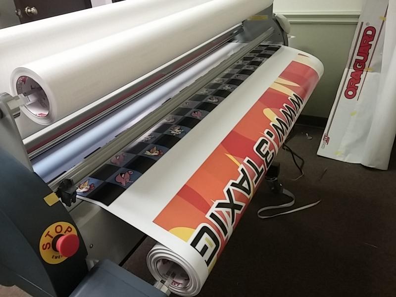

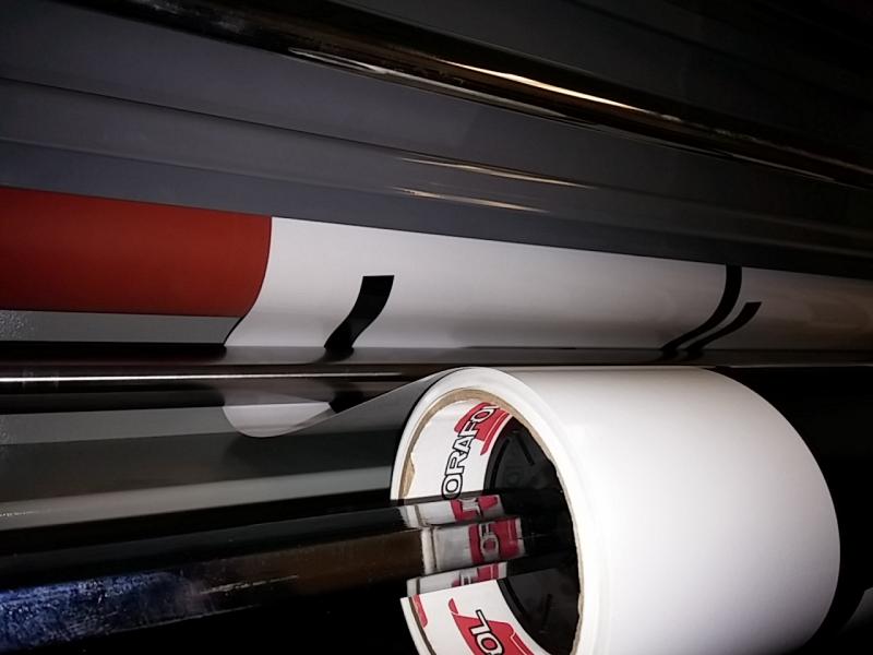

OK got it around the roller and into the nip.
View attachment 96616 View attachment 96617

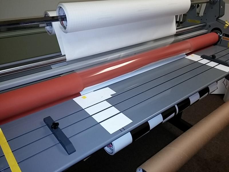

Now my issue is how do I end the job? Before when it was on the table I would use some left over backer paper as a leader.
After I finished the job, the best I could do has to raise the nip and slide some paper underneath the graphic. Maybe I need to add more to the back or is that front of the job and trim it off.
ETA: Just webbed another roll and no this is not going to happen unless I can come up with a way to get it turned around. I started to run out of swear words.![]()
Now you got it. That will keep everything snug and in line as it winds around the two rollers.
I just make sure I have six inch or so so I can pull on it once it leaves the take off roll. By the time it goes around the idler roller you should be able to hold it on the bottom pinch roller.

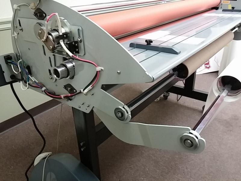

About the only thing I see it looks like you could use more tension on the bottom. And with the table on it looks like it would be hard to get it squared up around the bottom roller to load.
