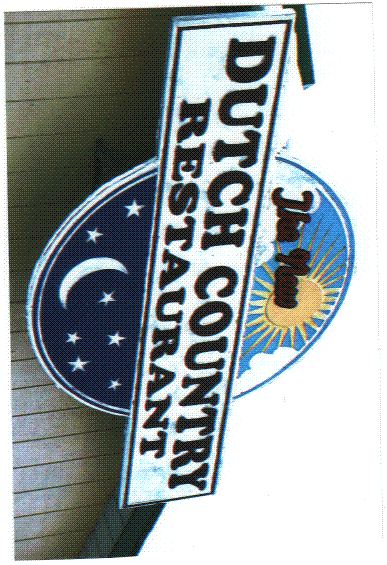

I used 3/4 mdo doweled with 3/8" dowels and a jig. Use bar clamps and glue. Then position 1 1/2" HDU to the sheets and glue. Strapped 2 x 4s, a few across the seams on the back side. Make your final contour, route edge, them paint. I used PL 400 glue. it's similar to liquid nails. (my first HDU sign BTW)
Here's a not so great photo, had to scan actual photo, winter shot also did not help. (10' long)

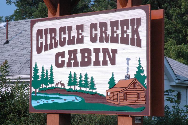

Here is my first dimensional sign I did. 2) 4 x 6 x 2" ceders panels. The customer wanted a a circle creek with a cabin that matched the color of his an some deer & trees. I said sure we can do it. I ask a sign guy about what to use... 1400 lbs of sand blasted over a hand cut mask, custom mixed one shot, ..done. If you know basics is woodworking, and can draw, you can do it and it is not that hard.
