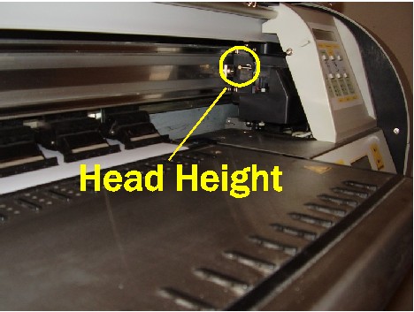

We had the same excact problem a few months ago. Go into your menu and re-set or set you head height. Nozzles are dragging. We raised ours and cured the problem. All media thickness's are not all the same.
Maybe I should ask..... how do you set your head height??? I've never messed with that before????
Derf
There is a lever for high or low.. or there is also a screw.. but don't mess with the screw unless you change print heads..

This is the only head adj. that I know of.

Ok, head height wasn't it. I have ran powerful cleanings and have soaked the print heads with a lint free cloth and cleaning solution. Phil Bennet at SW thinks there's some clogging going on BEFORE the ink hits the heads, thus the dampers being all nasty. Especially after running the lava inks.
