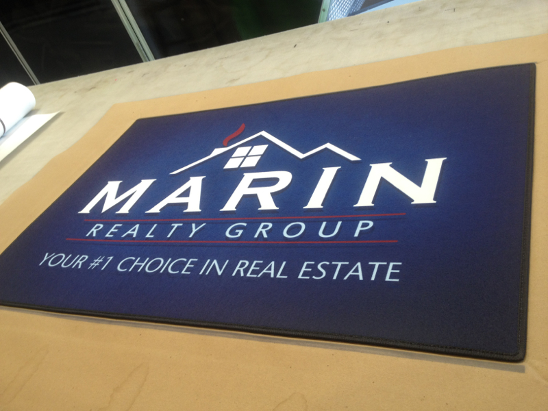

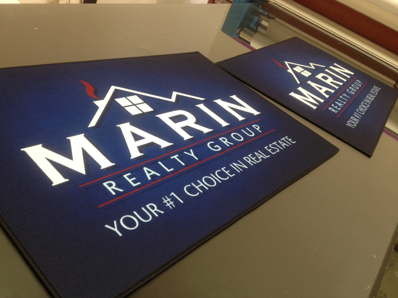

Also, I assume the rug comes white and you sublimate the ink on it. Is that how it works? or are you sublimating onto a black rug.
It's white. You can't dye anything on totally black substrate with sublimation. Only way is if a black rug had a white panel to sublimate (such as the case with black mugs, but there are issues with those as well).

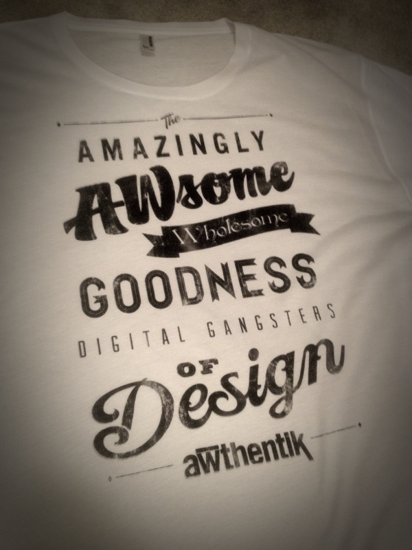

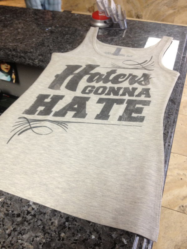

More fun..
I saw an old Allbright shirt and liked the style. Threw this together real quick.

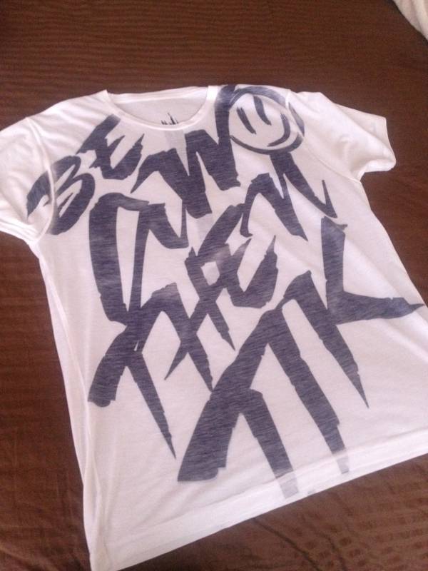

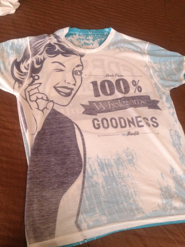

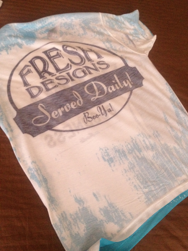

Tried some all over designs printed inside out so they looked worn and vintage. I think I like this type of application the most.
