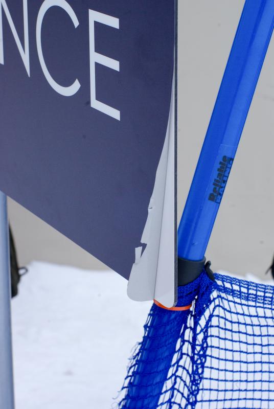

So we did these signs on Friday and they were put out on Saturday. today the customer sends us this picture. I am new to this and not sure I used the correct material. What could cause this and what should I have used.
Used Dibond substrate with a 3M IJ35 matte vinyl and a unknown brand matte lamination.
Sign is at the local ski resort so is regularly exposed to below zero temperatures.

This may be a silly question, but did you clean your dibond well before applying your graphics? And with what?
I use Dibond/MaxMetal ALL the time. But once in a while some comes in with oils on it. Maybe from the manufacture process, who knows? But its wont even hold the protective film. On certain sheets the, protective liner will fall off while sitting on the rack. I use iso or denatured to thoroughly clean the sign before applying the graphics.
Maybe one got by you?

I did clean them well with denatured alcohol. Also according to the customer this is happening on all 4 signs.

i doubt this is your problem but how do you use UNKNOWN materials?
Ok maybe that is your problem.

We are a franchise and when we started the company gave us a starter pack of supplies I am still working through that 6 months later. Unfortunately most of the materials were not labeled so I haven't got a clue as to what brand they are. I have asked repeatedly for a list of the materials we were given and apparently my request has fallen on deaf ears.
SlightlyChilled
Do you just work at the sign-o-ramma or are you the franchisy? If you are the Franchisy I would be calling your head people at the main office looking for help.
kanini
Could it be a laminate suitable for indoors application only? Or is all material you have for outdoor use? If it's a laminate used only for paper posters etc. indoors it could happen some strange stuff outdoors, shrinkage of the laminate for example...

not trimmed properly-- leaving an small "edge" for it to be "rolled" up
outgas before lam?
It does appear looking at it that someone messed with it -- a rolled up edge shouldnt have missing pieces lol

Was there delamination all over the panel or only just on the edges? My guess is the surface was not properly cleaned. I clean with Rapid Prep and then again with Rapid Prep again using unprinted paper towels. I pay special attention to the edges.

Everyone else thanks for the feed back we are going to get the bad signs back and see if we can fix this problem so all your feedback helps.
Also I have no clue if the lam was rated for indoor only since I don't know what it is. I would guess though that the company gave me outdoor lam.
