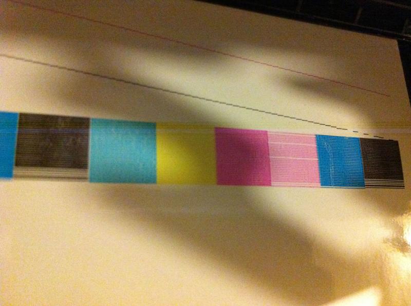

Ok, this evening I did a cleaning. As usual, it didn't seem to improve my nozzle check. However, after manually sucking ink through the heads and capping station with a syringe, my nozzle check greatly improved.
Based on this nozzle check, any recommendations? Should I keep drawing ink until I get the last few white lines out?

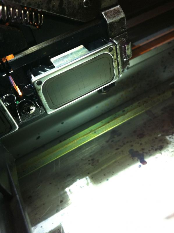

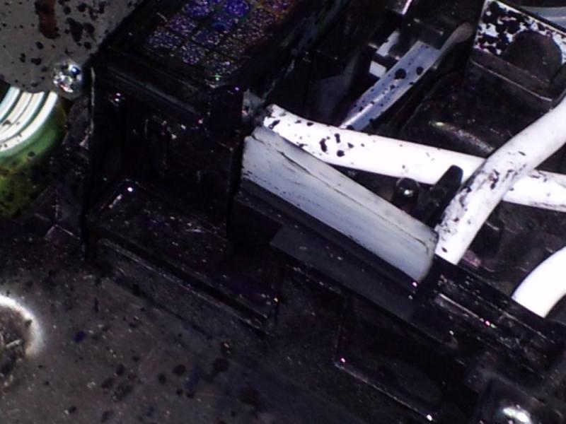

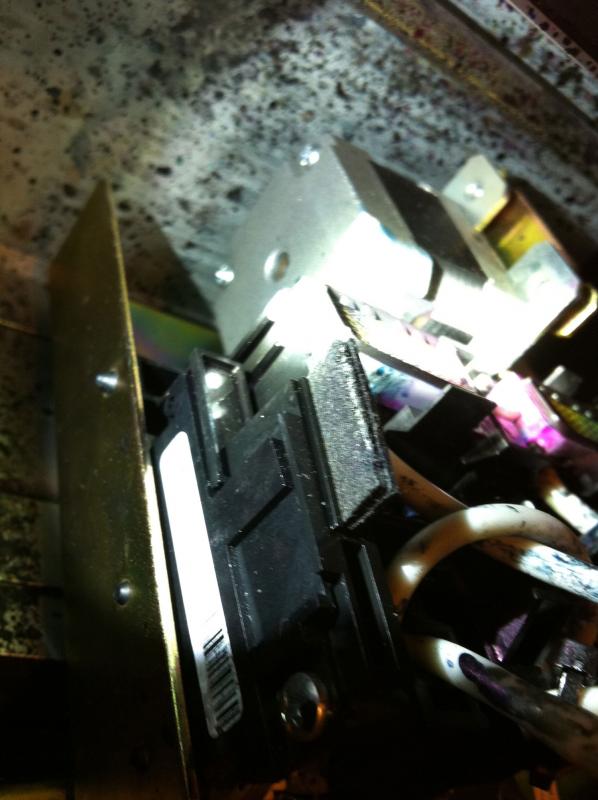

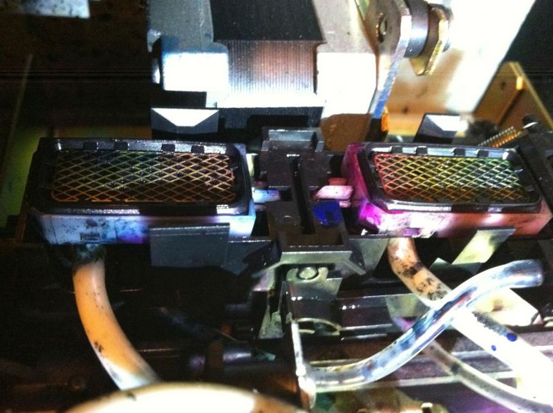

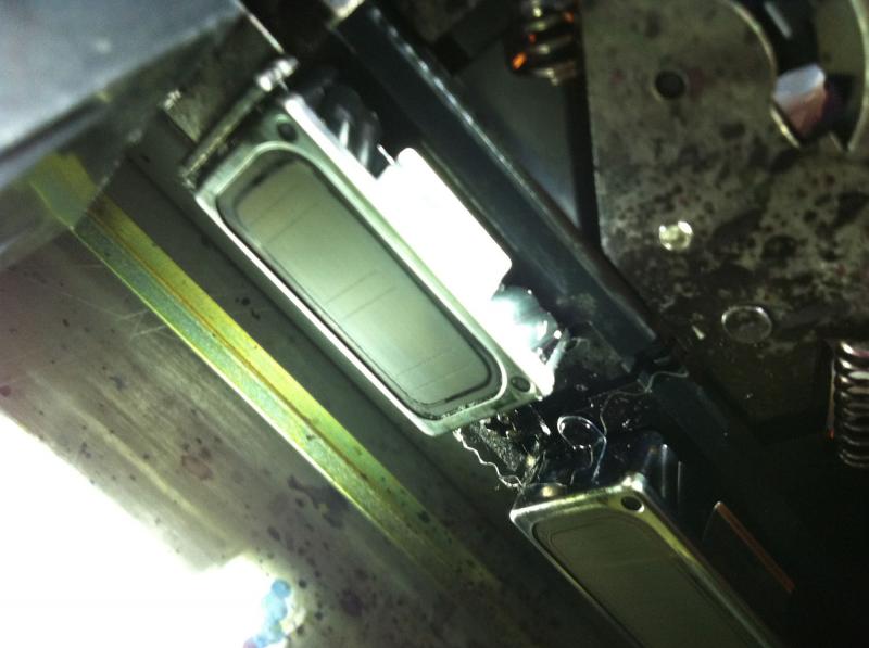

daenterpri
Ok, here you go :) What do you think? The ink around the capping station is from all of the work I've been doing on the printer.
Bradster941
Clean that wiper.
It should be completely flat on top.
Once cleaned, take your fingernail and see if you can separate it on top.
In the picture it looks like it is split down the middle or somehow there is (two) wipers installed. There should only be (one).
daenterpri
Ok, I'll do it! I think I even have a replacement wiper.
Do you think the wiper could cause the problems like I've been having?
laserman70
We had issues with that type of wiper. We went to the rubber one. Helped us out right away. Instead of wiping it, it seems to drag across and soaks it up which the wiper then holds. Next time you clean it leaves residue on the print head.
daenterpri
Do a few good cleanings and soak if needed. Should take care of it. Those wipers caused us headaches like you cant believe.
Ok, will do! We've done a TON of head soaks and cleanings... but hopefully now they will work right.
There is a definite "click click" when the heads go over the wiper now. Never heard that before.
