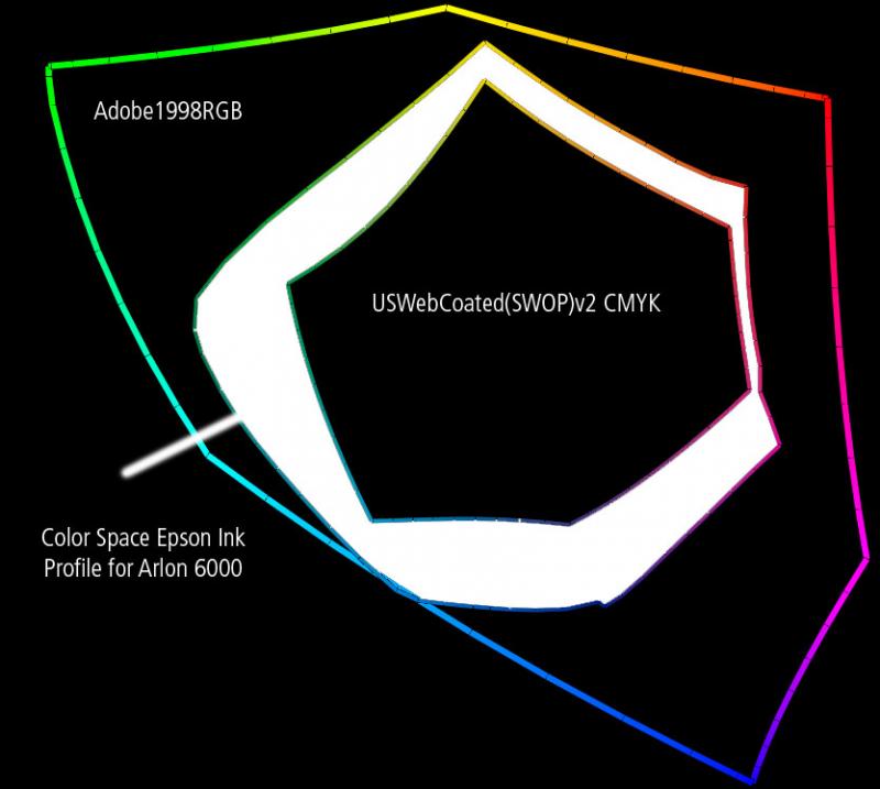

The simple answer is that cartridge based inks, in particular the Epson ink set (as well as most of the 3rd party ink sets I have looked at) are not 'process-color' CMYK.
Like I said the Epson ink set's gamut is larger than CMYK.
In the picture the RGB gamut contains both the Epson Ink gamut for Arlon 6000 and the CMYK gamut.
The white area is the overlap, this is the expanded gamut of the Epson ink set over the CMYK ink, so no the Epson ink doesnt cover the entire RGB gamut but it does provide more than the CMYK gamut and significantly more in some cases.
This allows one to print colors that are out of the CMYK gamut, which gives more pop, especially for projects like wraps.
So it can give you much better greens and blues, some better yellows and a bit more help in reds, where most people have issues.

I understand what you're saying because you guys got me to try it in the past. And it didn't help me achieve any better looking colors. I'm asking how that is possible when the Eco-Sol ink set is the standard 4 color-process (CMYK). But I now see why the Roland is able to produce much better looking color than the Mutoh by adding in the LC & LM inks.
RIP software's convert any document you throw at it to CMYK data. Therefore it can process any data, and make it printable.
So if you take 100% Blue in RGB it will than translate through RIP into a somewhat purple-looking color in CMYK. When you input your RGB document into the RIP it converts the colors to what it thinks is close enough to the CMYK value thus producing huge color shifts.
I've done plenty of testing to prove that no RGB document can output a wider range of colors using the standard CMYK ink sets. Putting a RGB document into a RIP that's converting those values to the closest CMYK values is putting a lot of "hope" when you need to be "sure" what your going to output. You never know what the translation of that color is going to become in the output and 9/10 it produces "dull" & "muddy" looking values of what the CMYK color should look like.
