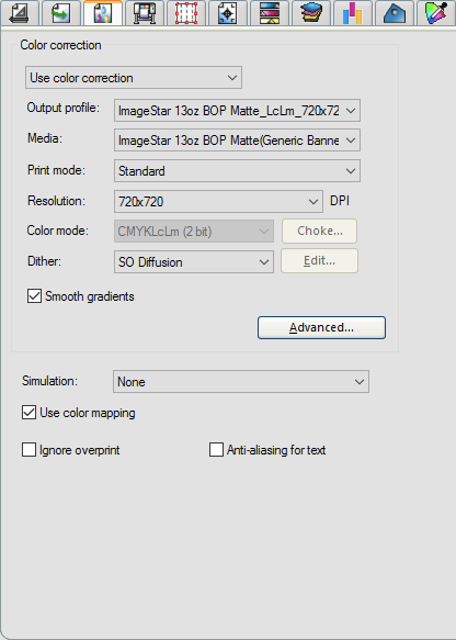

I was curious if anyone else has had issues with colors, I have a brand new (less then 2 weeks old) 800W and my colors are really far off. is there a color setting Im not aware of that I need to click? Flexi Rip, printing wraps on Avery 1105 or 3M 180CV3. I know the colors will be a little off which Id be ok with but they are not even close to the file color... Using Photoshop or Illustrators files PDF EPS dose not seem to matter. Any insight to this color issue would be greatly appreciated.
Haven't heard that before. Now that you say you have Flexi I'm pretty sure that's the problem. If you have done color calibration on the printer to that profile then it's time to triple check everything with your file exporting and flexi color correction tab.
You need to have the right profile there and color correction ON. The colors should not be much off from what I've seen.
Just example of the page, don't copy the settings:
_GdALwlkNFc1YkrkMc2_Bdqh-SCzlpb9gGEu4Xnp0wofmXB9TLiLoT-178pvLL6Tldn394mKGo6HBeInATAeADBv9vM5YKqyYU53kA78GqyyPHFgRK8LuWR6yGEtp4ZeCpg

Can you try and reload that example? For some reason I am not able to see it. Thanks
NIBP11
Thanks,
Mine is a bit different. DPI only shows 600x600 and I can not change the Dither option. Thanks for your help. I will see what I can find out. Thanks again

Thanks,
Yeah like I said, don't copy the settings. It's just a random picture from internet of the correct page.
