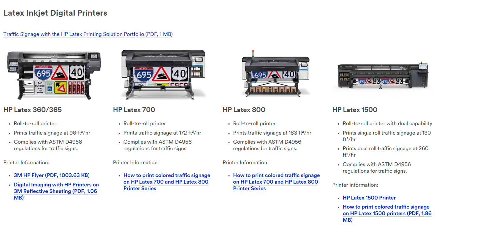

Not to speak for him but it's probably because he is a Traffic signage company and they are trying to get conversions to the new series of machines. Speaking of that, I think its crazy that the 800 prints faster than the 1500 on their traffic profiles.
balstestrat
Problem Solver
How so? It looked like both machines had profiles for 12-passes.
And you know speeds are obviously for full width.
L1500: ~24 m²/hr - 12-pass (dual roll should be used of course)
L800: ~17 m²/hr - 12-pass
Christian @ 2CT Media
Right off of 3M and HPs traffic website. This all goes back to the HP 1500 is a trash machine for other than entry level 10' printing. You can buy 4 800w printers and print 5x faster than the 1500. Also, the 1500 wastes 6-10' of Super expensive reflective stock vs less than 3'.
