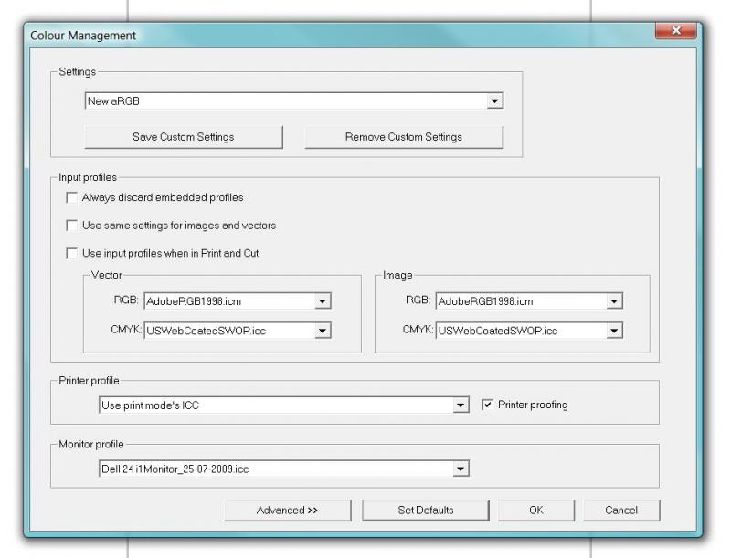

One thing I was wondering, since I am using a different RIP, in signlab do I turn color management off?
I would recommend you set it up the same as you would if you were using Signlab's rip.
Like I explained in the step by step over on Cadlinks site:
http://www.cadlink.com/support_train/forums/viewtopic.php?t=1670
Except, for the printer profile, where it says "use Printmode's ICC" you would select your Versaworks output ICC. The one you create in i1 Match.
This will mean Signlab will softproof using that profile and you'll get good WYSIWYG
