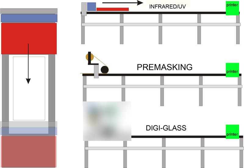

i'm already doing it. this new table for the printer is so big (7'x 24'), that i'm fitting a printer at one end and a pre-masker at the other end. i've got and old 65" walco laminator that i'm going to tear a part. maybe put a 7' roller on. but most likely just extend the shaft and i can just rotate the sheet if i go beyond 65".

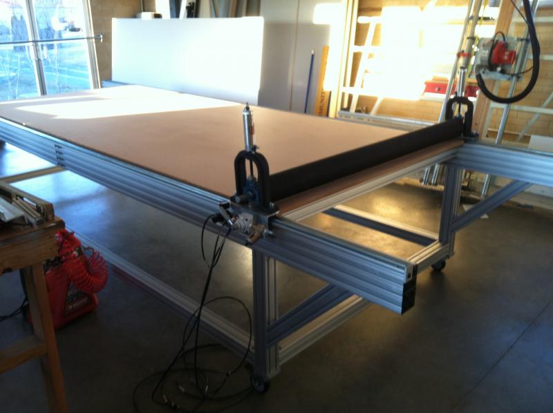

No glass. I don't need it to be backlit. Here's a pic. I still need to add a brace over the top to keep it running square and a self healing mat.
SqueeGee
$3k for the bench, casters, linear bearings, rails - all ready to assemble(cut, tapped, etc.) with shipping.
Laminator parts not included in that price.
Our production area is on the 2nd floor so I wanted to be able to assemble it.
It has a 5' x 12' work surface and the rails extend 2' from each side. I'll post more pics tomorrow.
