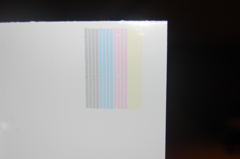

just did a printhead powerful cleaning and now I am missing a couple black nozzles??? Whats your opinion on me buying a couple cleaning cartridges and flushing the system?

Am I the only one who noticed that his nozzle test print was filthy?!
In post 6?
They look fine and should print great at any setting. A couple missing nozzles is nothing to sweat about.

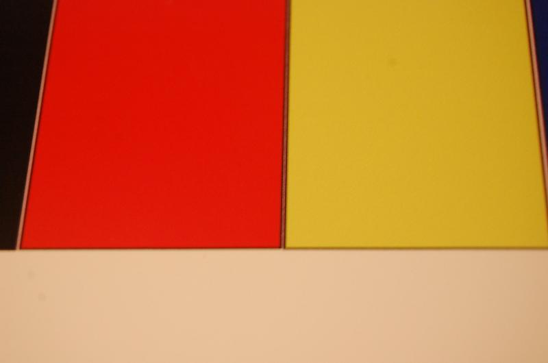

here is a closeup of yellows in my color chart

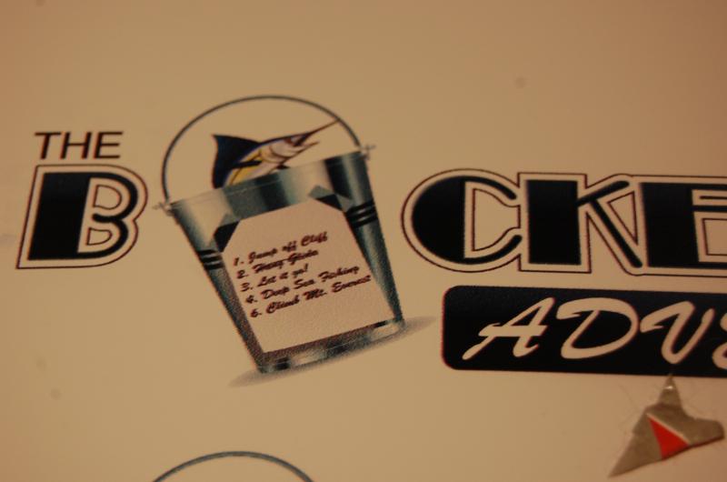

Not sure the problem I have been able to get ok quality printing but not what I expected. Was at Burger king today looking at a poster that was beautiful everything was crisp. Wishing mine was that way. Don't get me wrong at 30" + my prints look great but any closer and I see the dot placement.
Have tried slowing down the carriage speed and don't see any better results. Have tried several different types of media and problem still exists. with the exception of scrim banner it looks great.
Thought it might be a export issue but my color charts print spotty and I use the correct profile and have even tried several other profiles testing but no good results. If I do a double pass on printing it gets rid of the dots but the ink gets over saturated and looks awful..
Considering just selling and getting a brand new machine with a warranty!
Does anyone know how much average it would cost to have a roland tech come check it out? Problem is the nearest Roland service center is in St. Louis about 2 hours away. Would it be cheaper to just take it to them and drop it off?
This is driving me nuts!!!!!

The poster you've looked at is probably offset printed since they are made in large volumes. These SP machines will show a little dot placement if looked closely, and I think that's the tradeoff for ink longetivity. However, if you've managed to get some prints to look good and some that don't, then you have a software/file/setting issue. If you've never got the prints to look as good as from another SP then you need to get your machine checked out. Note that I said "as from another SP" because you really need to know if you have a problem with the machine or chasing ghosts... If your machine is OK you won't get any better quality from a new one with only 4 colors...
The nozzle test is fine, you don't need to do powerful cleanings (which you should be careful with anyways). Good luck!

Got some really good closeups of the dots hopefully someone can tell me if they are suppose to be that way!
