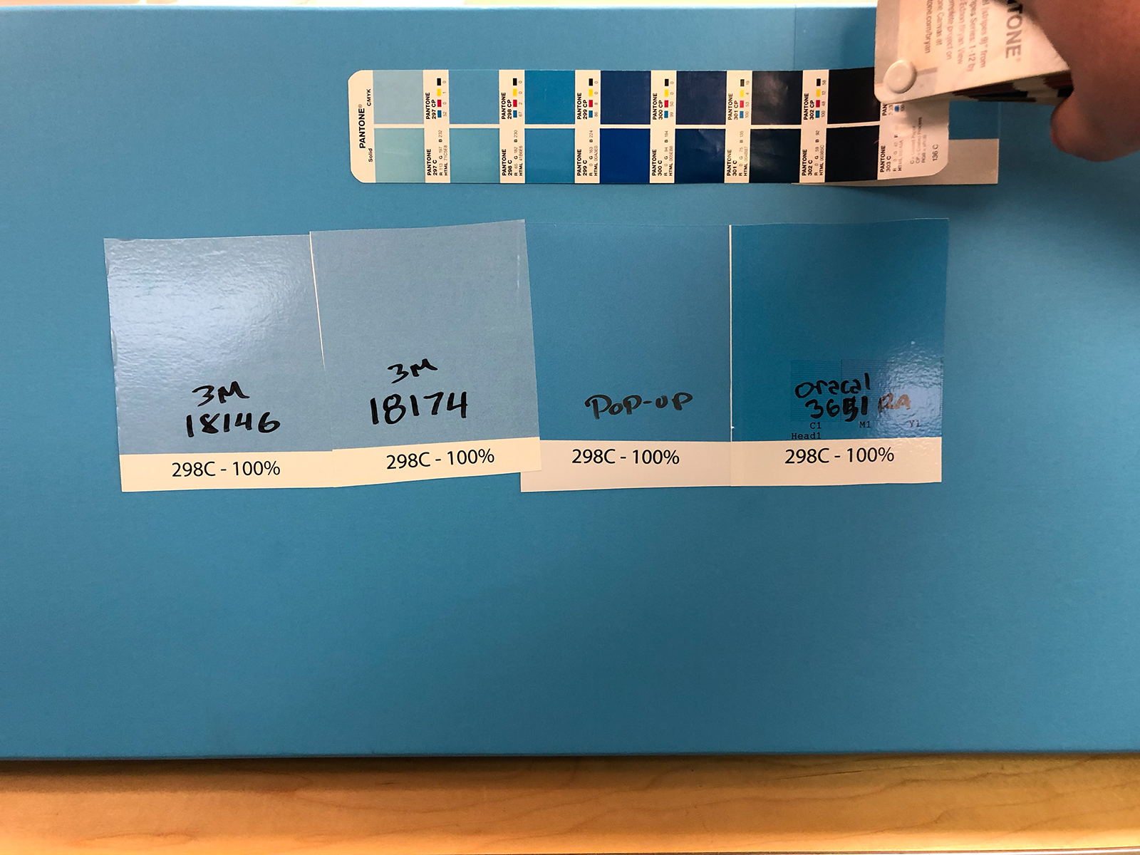

I do not know with 100% certainty that it is the machine, and not the material. If you look at previous posts, printing the same file, with the same profile, on a different material, the saturation of the Cyan either matches the expected Pantone color, or in the case of the Oracal media, appears slightly over-saturated. Unless I am totally missing something, I do not see how there could be such a drastic difference between 2 medias, and only in relation to one ink color, unless there was something going on with ink adhesion/absorption. It would make no sense for the printer to physically change how much cyan is being used on the different medias, because the printer itself does not know that the media has changed.
Then the confusion becomes that I have tested 3 separate rolls of 3M IJ180c V3, from different lot numbers. I could see having one bad roll, or a few bad rolls from the same lot, but 3 from 3 different lots?

Yes. The blue background in the photos IS the column with the original print on it. I will reattach it here. As you can see, it is over-saturated slightly, and that is printed at 95% density of 298C, so with the 298C printed at 100% (the 2 swatches on the left) being so dramatically different, and the other 2 switches on the right being fairly close, and all printed with the same profile.
I bothered testing the Pop-Up banner media and the Oracal media because I was starting to think it might just be a bad roll of IJ180C v3 causing the problems. Since they both print with correct, or even over-saturated colors, using the same profile as the 3M media, this would lead me to believe that the 3M media is the issue, but testing 3 separate rolls of 3M media makes me think it is either something else, or there has been a deliberate change in the 3M media or the Epson cyan ink that makes the two no longer work as they did previously.

I understand that different profiles for different medias are required.
I normally would not print a pop-up banner with the 3M profile. It was only done to see if it was an issue with the profile, or an issue with the media. (software vs physical issue)
The original wrapped column printed about a month ago was on 3M, with identical print settings as to what the sample prints use. In the picture, you can see that it is very different than the results I am getting now.
