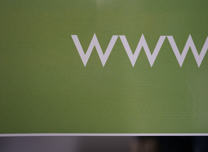

Is it possible to attach a picture with the actual "super banding" phenomenon ? The test print looks and is good.

This is a possibility. I noticed that ever since I put a polypropylene flooring tile down in the shop (over the concrete), I get a little finger zap every time I touch the printer controls, stereo or metal storage cabinet. But, this fine banding problem didn't occur until recently, and the flooring has been down for about a year.

As the banding is occurring on all vinyls, I don't think this will help. (?)
*Added: The image below was printed at 720x720

Yes, it was a RVW color. When I do a test print with some rectangles filled with pure C, M , Y or K, it doesn't happen; it looks perfect, but when examined with a magnifying glass, the lines are there ever so slightly.
