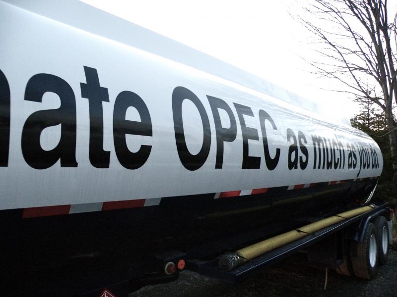

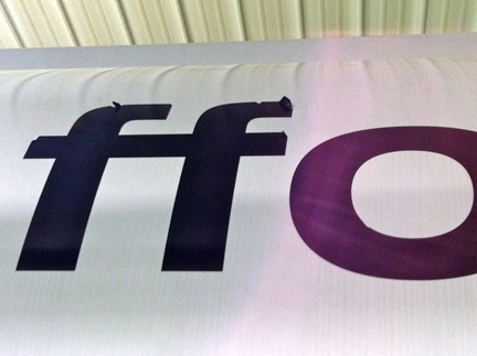

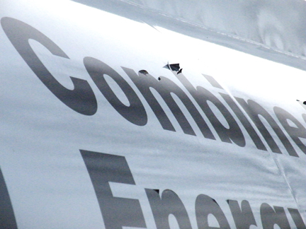

The first pic is the good side, the other 2 are the bad sides, every letter is like that.

Do you notice how it's just at the top, even on the rounds ?? That's a pretty good indication that something is running down on these and lifting your vinyl. To me, I would think after what you just said, they have a lot of spillage and when adding degreaser to gasoline that's run all over your lettering... I'd tend to think it's 'customer failure'. You can't blast these things with high power hoses and chemicals.

I'm also thinking it's something running over the lettering because if the failure was due to the paint or because it's calendered vinyl, I think it would've happened alot sooner than it did.

I'm with Gino and BlueFish. Even though I'm biased towards calendared ... the damage is on the tops of all the letters, got to be from something running over top of them ... doesn't take much at 60 mph with the adhesive at the edge being dissolved before it starts to flap and tear.

Customer states that they hadn't even used the trailers when they noticed it was peeling. They said they weren't even washed. I verified where they had been parked and there are no trees and nothing around them. They do own a pool supply company also, they store pool chemicals in a building about 300 feet away.

how are they filling these truck? might be since its on ONE SIDE, they are dragging the fill hose to the top and sliding a hard heavy hose along the lettering????????????????

Just a thought When the trailer was painted They would have went down one side and then the other. In painting the 2nd side they would have had over spray on the 1st. painted side. So 1 side is smooth like glass and the other has overs prayed particles on it.

With them being parked and not used is the side that is failing getting more sun exposure over the side that still looks good?
If so, the whole thing could be bad and right now the added heat of the direct sun might just be speeding up the rate of failure on the sunny side.
Old Paint's point is a good one but if they aren't being used it's not going to fly.
Not sure of the mainland but out here in the Pacific all top loading is being banned by the EPA due to vapor recovery issues. Our tankers have to be pressure filled from the bottom up. Before this we had all kinds of graphics damage along one side at the top from them dropping the walkway gantry down and letting it hit the tank as they reloaded.

Ditto. Oracal 651. 731 too thin. That may be your problem especially with such a climate change. Bo me if you want but been using 651 for 10 plus years. No problems and I live in Florida. By the new pictures, your cutomer is spilling fuel on your letters. Seen his before on a fuel truck I did for a airport. Sealed the letters with Frog Juice. No more problems.

+1 now the pictures tell a lot and that is they need to be edge sealed
