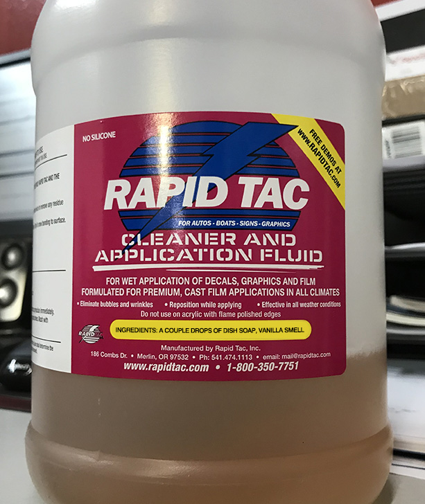

My answer is no. Since it has commandform, it would trap the liquid in and fail. Most printable vinyls you should only apply dry. Why would you want to wet apply it?
4' X 8's are extremely easy to lay down if you do it the proper way. Also some people do the dish soap route, but I won't, I use Rapid Tac for any wet apply application. I trust a professional product made for vinyl adhesive over trying to mix something myself and getting it wrong.
"A professional product" huh? You do realize a couple of old sign guys kidding around one day said hey "I'll bet we could throw some food coloring and vanilla scent in here, slap a label on it and sell this shit for 30 bucks a bottle" Long story short, one of them did, I don't think he's running a sign shop any longer.
ams
Mock if you want, but it works and the stuff is great.
He is not mocking you, only telling you that before the internet, if you wanted to wet apply, you used a couple of drops of dish soap in a gallon of water. Standard way of doing things. Rapid Tack is nothing more than that plus a vanilla smell. So you can pay big money for a couple of drops of dish soap or make your own. Same thing.
You do realize, Roger was never a sign person..... just a heck of a salesman. Just ask him. :u rock:
eahicks
By gosh you're right.....o_O
