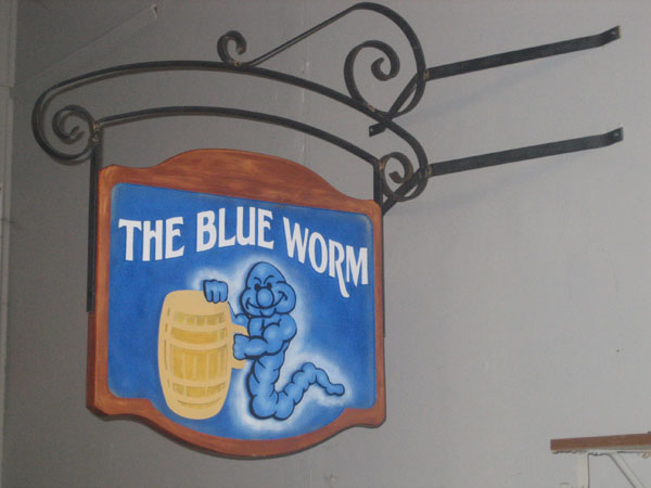

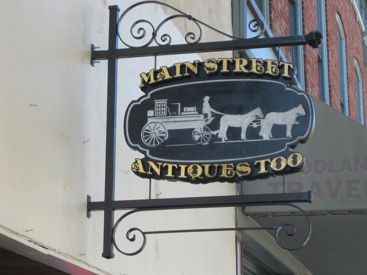

RogueRoller
I started small but made my own sign brackets, making my work stand out. make things for your shop and you will start selling them to the masses.
Here are two of my first signs that were not flat.
Nothing like today but they were a start.

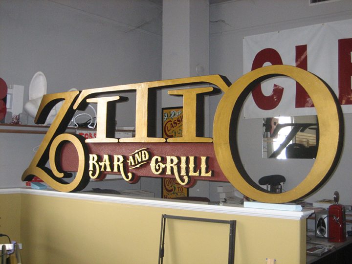

RogueRoller
You see the texture on the Gold Leaf (Bar and Grill) plus the Burgundy back ground that is with no Air. I did this to give me that texture.
How I did this was did the entire thing smooth then masked of where I did not want texture. Turned off the air and shot the texture.
By the way one of my favorite signs did not want to see it go :-(

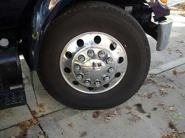

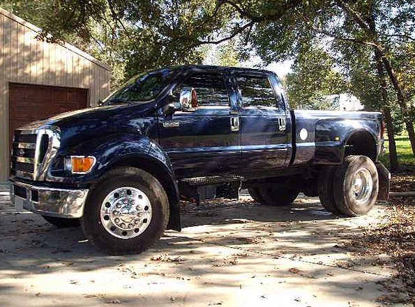

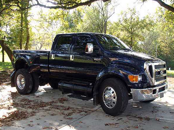

RogueRoller
You use GatorHyde for these signs? Isn't that stuff pretty expensive?
I wonder if real fiberglass is cheaper, or about the same as GatorHyde?
Are there any other products you recommend to be able to have a smooth glass like finish ontop of foam?
LOL OK for me time is MONEY $,$$$,$$$.¢¢
Could I do it cheeper with a more difficult product? YES
Would it be faster? NO
Would I have to do More Work? YES
Now would I be making less money? hmmmmmmmmmm YEP
This Is how I do it so I can live a life of not having to worry about if I can afford to go out and buy a new 650 Ford and pay Cash.
Because it was ether I spent 98,000 on the Truck or give it away for Taxes.
It sucks to Work Smarter.
Please don't take it wrong.
I just am trying to share with you folks on how I do it not to debate if I should work harder for my Pay Check to save a few thousand dollars a year.
My time is way to important. This is how I chose to take my Vacation.
Come on here and share some secrets. Help Some folks Out. For FREE ;-)
GAC05
Quit buggin' me
Do you own stocks in a gas company?
Whats the mileage on something like that?
I'm thinking Air Force One goes farther on a gallon of jet fuel.
Nice truck
