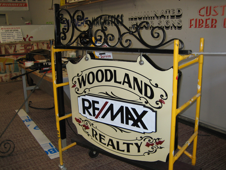

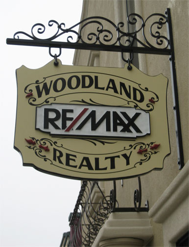

If you decide to give this type of work a shot keep in mind not all signs are mounted to a building. I make and design all my own sign brackets.
This sign bracket alone sells for $1,282.00 just the bracket. With out this bracket this sign would look very boring and not worth what I sold it for. Sign $3,460.00 Design was design time was $483.00. For a Grand Total of $5,225.00
Plus they had to have it installed by a contractor that charged the around $300.00

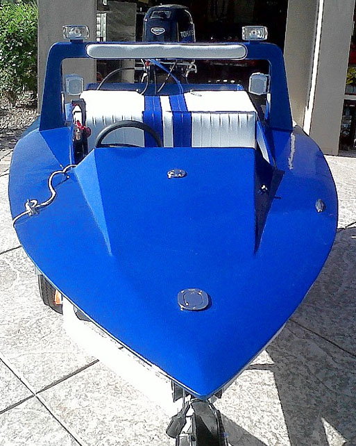

Thanks for input Let me go farther into what you really have in both of these two signs that you don't see.
The foam for the two signs were made from 3 LBS. EPS Quite rigid but easy to cut, sculpt, and sand to get shapes.
The shelling on both of these are Gatorhyde. they also have a fiber mixed in the shelling once this process is cured it is like as hard and rigged as a fiberglass roller coaster car. If you wanted to you could remove the foam and just have a shell.
Now for strength my mini jet boat goes up and down the Rogue River in Class 3 rapids And there are times you have to launch up a water Fallsby Skipping on a boulder and she is still floating.
Made from Foam With the same shelling process.
you see the foam is just to allow you to get a shape nothing more. This is also the way the Grill Sign Was done. :)
Hope this eases your fear.

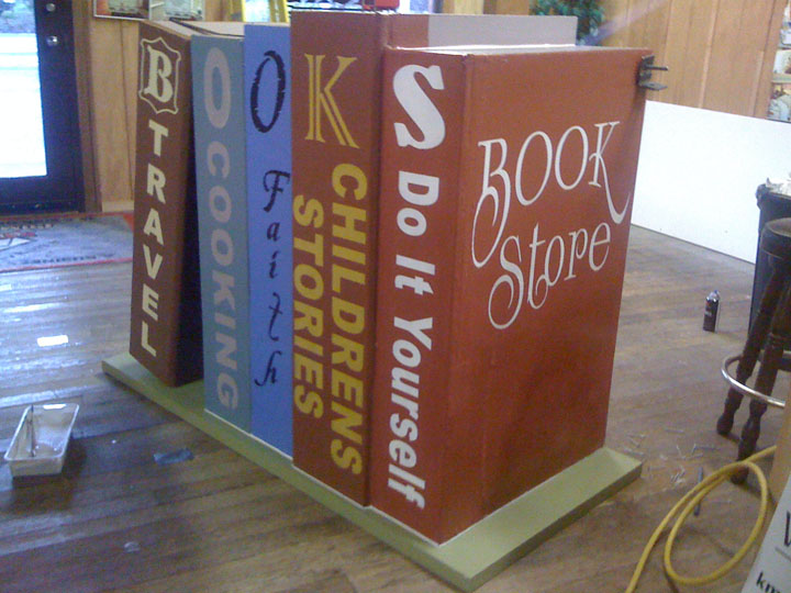

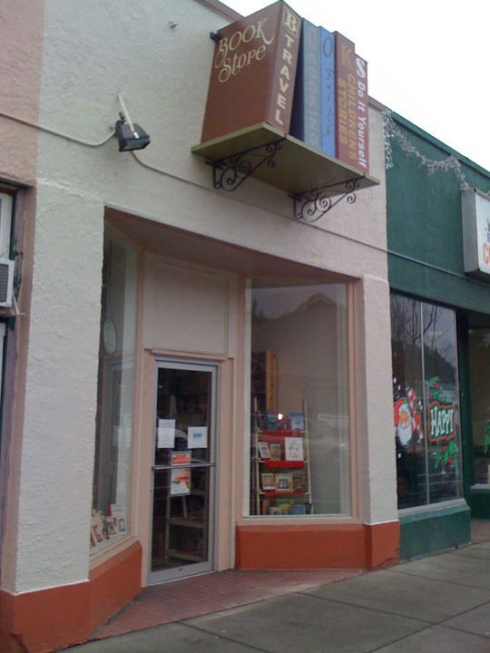

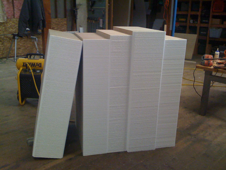

Here is a set of books maked with Door Skins, Foam and such. This was to get the shape I wanted. (Why wast foam when all i had to do in build some boxes and add some detail)
Then they were hard shelled.
The shelf brackets are for looks the sign is mounted by plates to the wall if you look at the pic of the sign in my studio you can see one of them at the top back.
Some where I have a pic of 3 people standing on top of them after it was installed.
Some times it is hard to get a city to approve these signs because they also think there is no way a sign made of foam or door skins would ever take any weight.
That being said there is a lot of engineering that had to be learned to do this large of a sign.
This is why one should study or go get some schooling. (small first then go bigger.)
