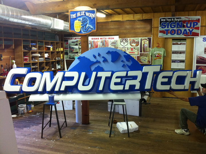

DC-3 Plane with Earth with a can sign with Raised letters.

This sign was done using Stiro Spray 1000 then painted using latex 25 year Paint from ACE Hardware. Cost to build this sign around $250.00 Sold for $1,768. This sign took only 13 hours to make. With out a CNC Machine. (any questions?)
That was start to finish time.
Time dinkering with it was about 3.5 hours.

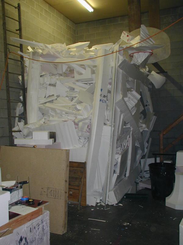

So.... What do you do with all of the scrap?
I did a huge project a couple of years ago with EPS and the biggest problem that we didn't consider was the amount of scrap. Nothing that was big enough to save ended up in the scrap corner. This is a picture of the corner of my shop towards the end of the project. If my scrap pile is this big, yours must be mammoth.
Get a hold of me and I would be glad to show you how to take your trash and turn it into 1000s of dollars I recycle every little flake. :)
I will show you how to make it back into usable product to carve another sign out of it.
This is one of the things i teach in my classes.
