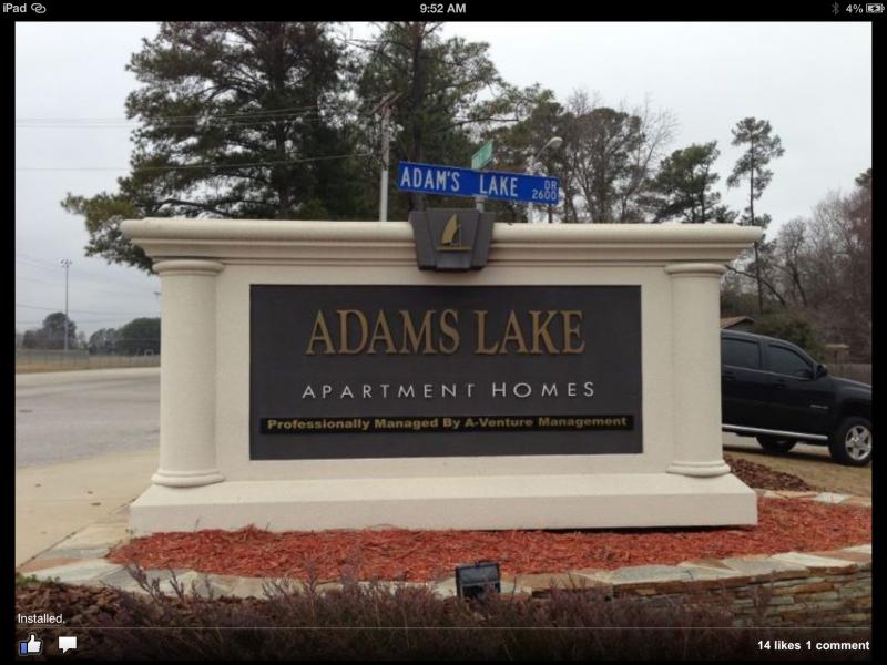

I agree the panel with letters to cover up where the first letters were is the way to go. Second I was wondering about the paint because in some spots it is splotchy and fading. So I wanted to give them a price(option) of repainting it to spruce it up a bit and wanted to make sure I used the correct paint so it would last and not flake off. The sign has been painted before because there is over spray on the letters that are on there now. I would tape the letters that are on there up (shouldn't be a problem i've done paint and body work all my life) paint it and then apply the new panel w/ wording. I was just wondering if the silicone would come off easy or if there was a trick so I would no if no panel and just wording was an option. I definitely don't think i'm in over my head. I don't want my inexperience with hdu or dryvet to be mistaken for ignorance. I'm competent, just wanted to get some opinions. Research it before just flying off at the handle. I agree also that its NOT a restoration job (and lord i don't want it to be) just thought it'd nice to offer to repaint which would be affordable and a nice touch up. So I guess what my question boils down to is.... Latex paint will it stick to Dryvet and last? Also,where can I order Gemini Lettering? The main site says they only sell through dealers.

I don't want to get in the middle of this because Jill does know her trade and based on all the posts she has, she has expertise. All that said, this monument looks like it is stucco and it can be totally refurbished to look new. You will need to take it down to the basics, cleaning, painting, replacing all letters, etc. It will take someone taking time to give the cutomer a quality product. I don't believe you will need to start from scratch....but maybe you should pass to someone who is knowledgeable in this area. Karma

There isn't any way to get all the silicone off a textured surface and you can't paint over it.
The fastest, cleanest and cheapest way to do a professional job is to remove the existing lettering and cover up the background with new panels.
I'd price this out in the same way as if were panels going on an exterior wall.

In case anybody wondered how it turned out.
