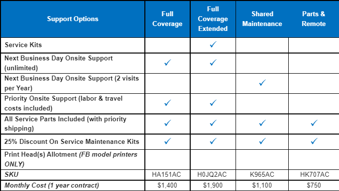

Now my warranty is up, and in case anyone is wondering here's what HP's extended warranty costs are:
Unfortunately, in my opinion, the contract is not worth the bill. HP designed a machine that when properly cared for does not require many on-site visits from technicians. I believe I've seen most, if not all, catastrophic part failures and fixed them myself at this point. Once you know the procedure for fixing these things they are simple and require minimal tools. The most memorable machine failures so far are:
cistern had ink in it- 1 person fix, 10 min
pip sensor got ink on it - 1 person fix, 10 min
alignment bar / gate failing - 2 person fix, 60 min to swap out a motor
carriage belt ripped itself in half - 1 person fix , 20 min
white intermediate tank exploded - 30 min clean up
white ink box exploded - 30 min clean up
Perhaps if the warranty included a print head allotment I would reconsider. I will ultimately see if my decision to go without warranty is wise. The priority parts shipments are the only real benefit I see in that chart. And I'm sure HP prices their parts at a fair rate without warranty... :rolleyes:
