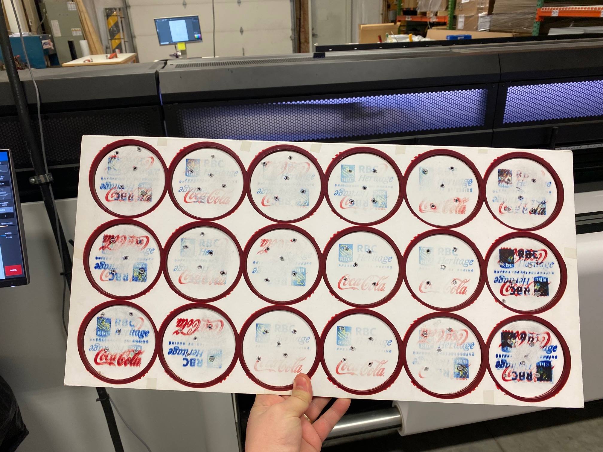

I made these sleds from three layers of 60 point chip board. I drilled holes on each slot so the vacuum can hold down the pulp coasterboard. Set up my file on illustrator with thru cut lines, cut it out on the summa then use the same files for printing as sheets. Works perfect for alignment. Print 15,000-20,000 at a time and don't lose a single one.
As far as actually fixing your alignment, I saw balstestrat answer this and I agree with them. Before you run the calibrations I suggest cleaning the encoder strip with a clean microfiber and distilled water.

Thanks RJH, so with your template or skid you are placing coasters in there individually I am assuming that are already precut? We are printing the full 40x60 sheets then cutting them on our summa.
John
