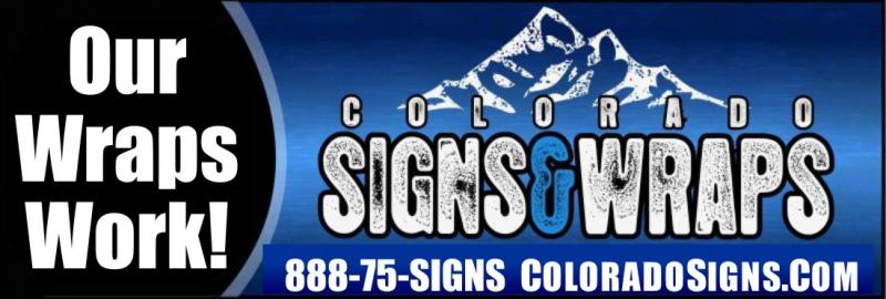

Need Billboard design feed back ASAP!!
Is this gonna be LED's or posted ??
That will make a huge difference in how people will see it... especially at night.
I might add, I'm no fan of the LED billboards.
Just saw that one...... you're still using the word 'WRAPS' and for the most part, no one really knows what that is to begin with and you've used it twice. Without some sort of picture, they might be thinking of a wrap sandwich.... or a wrapped electric can.... or even a singer in some rapper band with a play on spelling. You might even be a Christmas Wrapping store. Too many possibilities. Climb out of your head and look at all the signs you see and what attracts your eye to which ones and why. How much do you really comprehend in a simple drive-by ?? Now, for a test, take a buddy with you while driving and ask him to tell you what he sees. See how many billboards he points to and if he/she does.... why, what made you see that one ?? Don't hint around at what you're doing, but if he knows you're in the sign business, he might look at signs on purpose, but see if he notices billboards. Like said.... they're real job is for logo or customer reinforcement.
Again, you only have 2 or 3 seconds and with that much confusion, I think you need less words and a great picture, but not both web and phone. One or the other.
HulkSmash
Thanks everyone for the free advice. I WILL take advantage of it! :)
Gino- NOT Led. It's a regular billboard with 8 powerful lights on it.
briankb
looks 10x better than the first post. I still think that you should simplify the left a little more.
I think just "GET YOU BUSINESS NOTICED" or "DESIGN YOUR BUSINESS TO GET NOTICED" you don't need the period.
the telephone and web address is too big and needs a little more space; just make it a little smaller. I know you feel attached to you toll free but if you dropped it and spaced out your web address to fit the same (or smaller width actually). It would stand out even more and people who need your service will remember a web address much easier. Especially since your web address is so simple.
