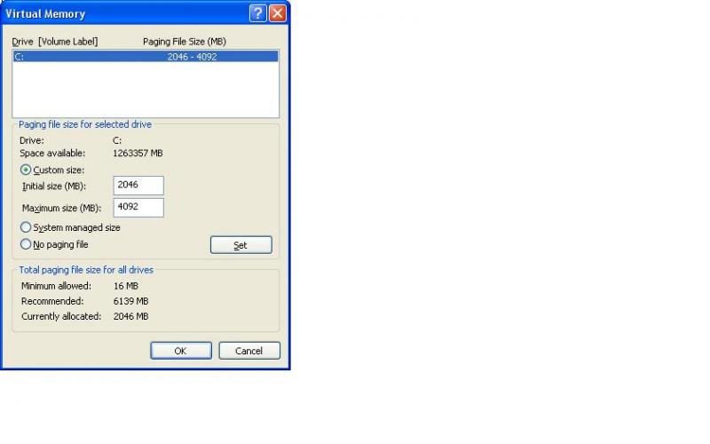

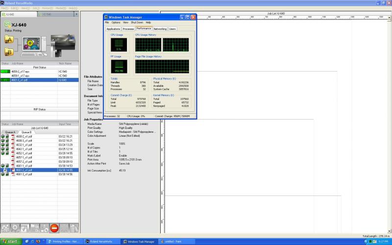

Here is my page file usage at the moment along with my page file settings in Windows. These are the two printers on the one machine. I'm just fixing the other RIP at the moment.

In addition to the above, I also put my pagefile on a different drive, and fixed the size of it so that it isn't made bigger and smaller all the time by the system (apparently this can fragment it and slow things down too).
I've been dealing with some big files the last week or so as well so it's re-assuring that there haven't been any lock ups/hangs.
