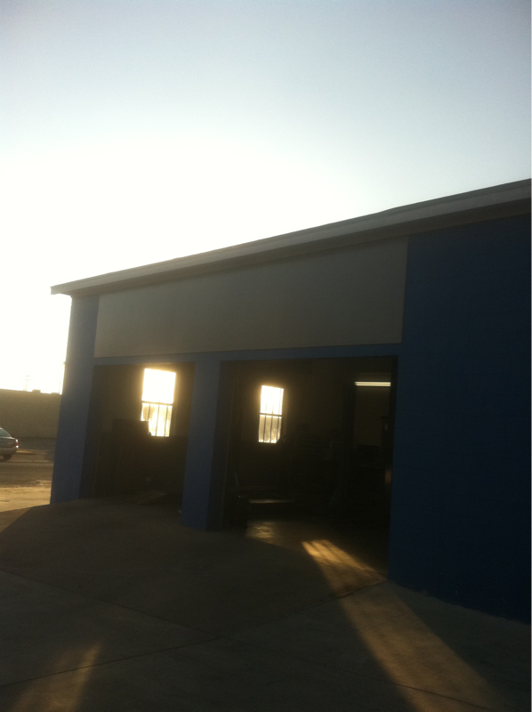

Vinyl not sticking on painted wood.
Aragons
I thought i was going to get good advise not critism but anyways im learning.
So i removed vinyl and repainted wood with semi gloss oil base paint what should be my next step? paint is drying right now.

NExt step????
Test every thing you do for yourself before you try to make a buck from a client on the unknown entity.
Aragons
So your saying that the wood I just repainted is not going to work

Dave Drane
Probably not. down the road the surface will "crocodile" because you are using 2 different mediums. The enamel will be drying out at a slower rate than the latex and will pull it open into cracks that look like a crocodile's skin, thus the name.
Si Allen
Sorry Doug ... you have it backwards.
Water based paint does not bond well to oil based paint ... but .... oil base on latex, sticks like baby poop to a blanket!

Although I would not have used latex in the first place.....that being said, I'd say you were good2go.

I did a few $1000 sandblasted signs with custom mixed latex house paint, over quick drying Zinsser oil based shellac primer, and they looked awesome for years..
...but then on a different job, I painted 1-shot oil based paint over tan colored pre-primed 1x6 boards from Home depot & the crap practically fell right off... so I assumed it was a paint incompatibility... which led me to my theory...
...my new theory? I'd follow Si's advice...
regarding the vinyl choice, I'd suggest you wait 3 days to apply any vinyl.
A lot of us refuse to buy Avery for reasons i won't go into... but if I had new Avery vinyl today, I would trust it... I just would never willingly give them money or advise anyone else to... do, don't buy any more... but what you have should work if it's not 4 or 5 years old...

I'm going to let the paint dry for a week it should be enough time.

We do use oil based paint on some signs and then apply vinyl but usally we will not do it that way because it does not last as long.
Avery has had some failures in the past , oracal would be a better choice.

Anyway, oracal is ... ok... but i prefer 3M, so that's what I use.
like previously stated. latex over oil = NO...
Oil over latex= OK.
Next time, don't use wood.
