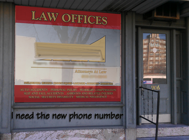

There are two maroon panels that go down first. Each one is 14.5" x 96". Usually, under normal conditions, we'd do it dry, but we thought with all the talk of this tacII stuff making things go so much better, we'd try it. Trying to get a 15" x 95" piece down with no bubbles ain't easy.... for anyone..... dry or wet.
We are not dry experts, but we do a lot of it. We've messed them up already in the middle of summer doing it dry, but not often. We just guessed wrong and this one came back to bite me.
I didn't even discuss charges with this company, but after all of these great reviews as to our doing it wrong, maybe I'll reconsider talking to her about it. What this job is paying and how much this company gives us a year.... I could re-letter this window 15 times and still make money.
Here's a picture of it of what it will look like when it's finished, just not as blurry.

Can I ask you or anyone else here...after seeing the pic I want to know how if they were applied reverse you would deal with the liquid that gets caught between layers?
Thats another nightmare scenario.
If we do it in reverse from inside, we won't use any liquid. Anyway, not tac II, that's for danged sure.
If one was to do it wet, cause we did like 25 or so years ago when we didn't know any better, you'd do the lettering, and then wipe it down good and dry and clean any smudges and stuff away. Wet the next layer lightly and then squeegee the livin' dickens out of it so no wetness remains back there.
The wet method isn't really all that bad, it's just a mess and takes extra time. Some products work and some don't...... It does tend to make beginners feel more confident when positioning, but once you know what you're doing, I don't think many people stay with the wet methods.

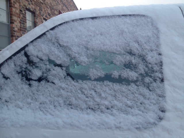

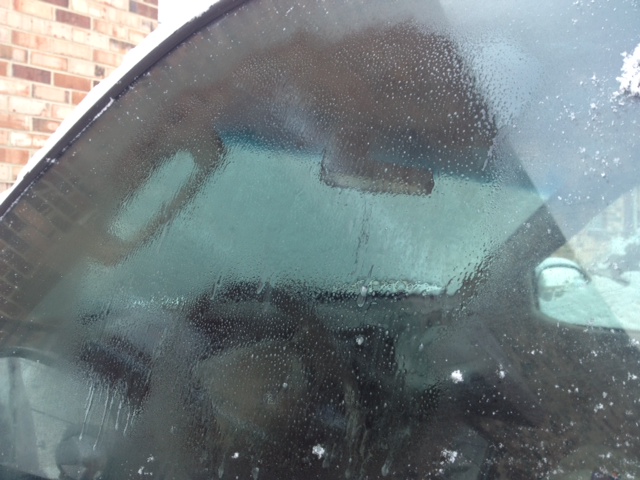

Funny, we all had the same idea. Here's my test this morning. It snowed last night, it's 18 degrees when I took this, this morning.
Wiped the snow off, used the sample bottle which atomizes really fine, and lightly sprayed it on. Nothing happened. Sprayed some more on, nothing happened, other than it ran down the glass. Wiped it off. No issues.
Someone watered that batch down, I'd guess.
