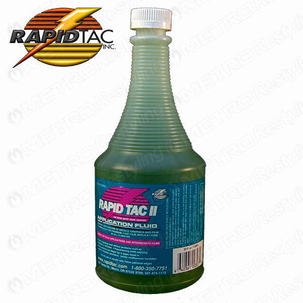

We got everything ready and then we discussed last week about the frigid weather coming and decided to give Rapid II a try, since it was designed for glass in totally stoopid temperatures. Got there, cleaned the windows, made our marks and the darn stuff froze before we even got the vinyl to touch the glass. We're talking maybe a 10 second delay from spray time. The frickin' sh!t inside the bottle even froze. Whadafug ??
Now, I know it's God awful conditions to be working in, but our people will do anything I ask.... even stoopid things, but for this weasel p!ss to perform like this just goes to show why this stuff is total crap.
For fast, easy, quality installation of vinyl graphics with no bubbles. Rapid Tac II recommended for cold weather. Change is good. Back in the day choosing a vinyl film was easy with basically two film types, cast, and calendared. Nowadays things are a little different. Sign and graphics professionals now hove more types of vinyl films to choose from than ever, with more adhesive types as well. Rapid Tac II was developed to work with a wider variety of films such as the economy calendared, intermediate calendared, high performance calendared, metallic, reflective, polyester, mylar and other specialty films). Rapid Tac II promotes bonding faster than the original Rapid Tac application fluid and is ideal for cold weather and glass application. Rapid Tac II is not a replacement for the Original Rapid Tac, and may bond too fast with "Premium Cast" films in warmer conditions. STEP 1. Clean surface thoroughly with Rapid Tac II and a kitchen paper towel. DO NOT USE OTHER CLEANERS OR SOLVENTS. (We do recommend Rapid Prep as a pre-cleaner for surfaces that may have been exposed to wax, silicone, or other suspected contaminants) STEP 1. Clean surface thoroughly with Rapid Tac and a kitchen paper towel. DO NOT USE OTHER CLEANERS OR SOLVENTS. (We do recommend Rapid Prep as a pre-cleaner for surfaces that may have been exposed to wax, silicone, or other suspected contaminants) STEP 2. Spray surface again with Rapid Tac, peel backing off decal and place on wet surface. STEP 3. Position decal and spray top of decal to minimize scratching. Use squeegee to remove fluid, using a good deal of pressure and working from the center out to the edges in all directions.

I've used it in the 20's many times. Never once had an issue with it freezing. In their defense, it does say "Cold Weather". Define cold weather. 30? 20? 0? -10? It's a relative measurement.
You're further north than we are and it was freakin' cold, so I'm guessing you're less than 20? Maybe that's just too cold for it.

As for the temperatures.... it's around 14º with a wind chill of around 0º. I got my idea from the many saying they do this all the time with Rapid II in -7º and less..... mostly up in Canada.
R O G E R has mentioned his utubies many times in the past..... and it states about doing it out in 17º without any problems while it's snowing. He goes on to say, it can be colder and it sill will work.

I call bullscat..
IF its -20 below with a wind chill what the hell do you expect. Geeses .
64 proof liquor freezes at -10°F. 24 proof liquor freezes at 20°F
RT is about 1/4 alcohol. Whatever proof that is I do not care to calculate. But i guess it is around 24 proof.
I know the tempts are hovering down around 10 over there with a wind chill down around -10 so give it a break. Calling it crap???
I just did an install and the temp was 22 and it worked just fine. If it isn't down around 10 over there.. Someone watered down your product. Or it was some HOME MADE weasel **** for sure.

50 proof or double the percent

I got some for a window application, thinking "Hey, Its made for windows". The graphic that I had to apply was 46" x 56", cut vinyl (2) pieces.
Never again. I applied it, and it never "stuck", and this was in the summer time.
I will only do glass applications dry.

Just curious, what was the material? I have a customer logo that uses 3 different brands of vinyl to get their color (they refuse to use print and cut), and the oracal sticks like glue using it, the trim and avery both have a tough time sticking with it (at least the product we used).
I used RapidTac and II for 2-3 years when I started out. Never once had a problem with either.

I prefer doing dry glass installs in the winter time...
freezing temps, the vinyl "floats" on its own frozen adhesive. little love with the heat gun and a squeegee, before removing the mask, and ur set!
I am a rapidtac fan, but definitely not in these conditions... no matter what the label says.

Wind chill doesn't affect objects it's just how living things feel it. If it's 10 with a -10 wind chill it's still 10 to the window and rt. Not that it makes a big difference it's still freaking cold. Was it a new bottle? Or could have someone refilled it with something else?
