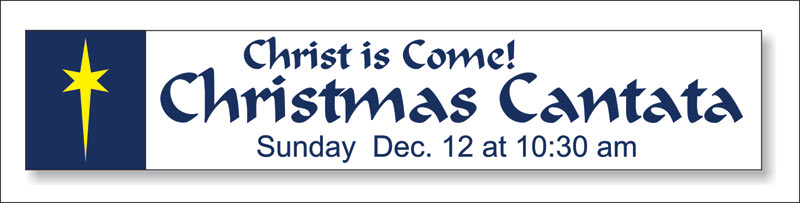

Another try
Hi again! Okay, here is another try based on the feedback. I hope I have heard all of the tips and incorporated them here. I would like to do other designs, but know there is very little time.
Now, somewhat in order:
1 - Changed from the Porno font! (ok, so now I know! haha!)
2 - I lowered the right side and lined up the top and bottom of both panels.
3 - Then, because I don't think I have the skills, yet (or the brass to learn on something this big!) I changed the background color to gray with the hopes that I will not need to cut out for the yellow star.
4 - Last and not least, sign up for the premium membership so I can look at more examples of how folks who know what they are doing do things!
JimmyG - thanks for the vote of confidence! I am hoping to be ready to "apply some stickies" soon!
Am I getting close yet? Thanks again folks! :thankyou:

It' really coming together with all the help and your own input. It's refreshing to see someone not just use someone else's ideas, but to learn from them and incorporate these new findings and ideas and make them become part of you.

I think you have it Hightop, go for it...
the last drawing you show and your chosen font will be way more readable...grey background will work fine layering on dark blue vinyl text..
the only other thing I would do with the "yellow" star is use a white outline "separation" from the grey background and go with a darker yellow like chrome yellow or imitation gold vinyl, depending on what yellow colors that you have on hand....

fix your spacing... text in white area too far right. Way too much padding.
Text in gray box too tight to edge.
Maybe move "christmas cantata" to the "Join us" line. Then make the 'Jesus is come" a little bigger. I think the gray box could be a pinch bigger. Think rule of thirds.
signmeup
If you're selling a "Christmas Cantata" it should be the biggest thing on the banner, not the smallest. Tell 'em what it is and when to show up......
"Christ is Come" doesn't really need to be there either.

I think it looks lots better!
I assumed "Christ is Come" was the name of the church.
I still would tighten up all 3 lines at the left if I could... and I like the alignment , so then I'd adjust the right side... and to help with that, I find that "Join Us" while sounding friendly an all... is entirely unnecessary. Take it out, or even add "Join us in" to the top line.
Test a piece of yellow on gray. it still might get muddy. The idea above, to use darker yellow, AND leave a white space... I would do that !
signmeup
AUTO FX,
The font is "Calligraphic".... needs to be kerned. The font wasn't the point though. The point was to get the message out as efficiently as possible. People driving by don't have a lot of time to read a banner so keep it short and sweet. IMHO anyway...
